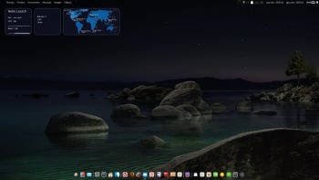

#2434 2025-10-02 18:33:50
Posts: 1,075
Night wallpaper with just 2  conky

${lua fDrawImage $HOME/.conky/Tahoe/monde/monde.png 0 5 320 149}
