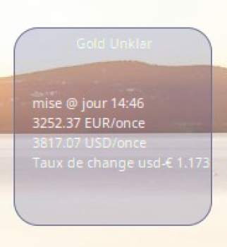

Funktioniert bei mir, habe dies nur hinzugefügt, um eine Datei zu haben, die ich überprüfen kann.
conkyrc
${alignc}Gold Unklar
${texeci 300 bash $HOME/.conky/Tahoe/gold/gold.sh}
mise @ jour ${execi 300 date -d "@$(jq -r .timestamp ~/.conky/Tahoe/gold/or)" +%H:%M}
${execpi 6 cat $HOME/.conky/Tahoe/gold/or | jq -r '.gold_eur'} EUR/once
${execpi 6 cat $HOME/.conky/Tahoe/gold/or | jq -r '.gold_usd'} USD/once
Taux de change usd-€ ${execpi 6 cat $HOME/.conky/Tahoe/gold/or | jq -r '.wechselkurs_usd_eur' | cut -c1-6}gold.sh
wget api.edelmetalle.de/public.json -O $HOME/.conky/Tahoe/gold/gold.json -o /dev/null
jq --raw-output . $HOME/.conky/Tahoe/gold/gold.json > $HOME/.conky/Tahoe/gold/or
exit------------------------------------------------------------------

Work great with my cac40 conky
${alignc}CAC 40
${texeci 300 sed -n '11p' $HOME/.conky/Tahoe/bourse/info_cac.txt} Pts
${texeci 300 sed -n '12p' $HOME/.conky/Tahoe/bourse/info_cac.txt}
${execpi 300 wget "api.edelmetalle.de/public.json" -O "$HOME/.conky/Tahoe/bourse/gold-raw"}
${alignc} OR
mise @ jour ${execi 300 date -d "@$(jq -r .timestamp ~/.conky/Tahoe/bourse/gold-raw)" +%H:%M}
${execpi 6 cat $HOME/.conky/Tahoe/bourse/gold-raw | jq -r '.gold_eur'} €/once
${execpi 6 cat $HOME/.conky/Tahoe/bourse/gold-raw | jq -r '.gold_usd'} $$/once
Taux de change $$ - € ${execpi 6 cat $HOME/.conky/Tahoe/bourse/gold-raw | jq -r '.wechselkurs_usd_eur' | cut -c1-6}
${lua fDrawImage $HOME/.conky/Tahoe/bourse/diag.png 20 51 130 72}
${voffset -200}
${execi 350 ~/.conky/Tahoe/bourse/cac40.sh}Last edited by loutch (2025-10-01 13:01:19)
