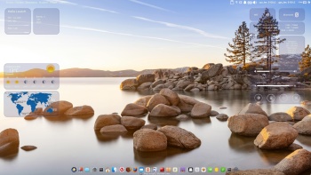

Night wallpaper with just 2  conky

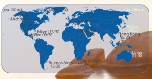

#2435 2025-10-03 08:45:44
Posts: 967
Guys i need your help .
I can't find the error in my conky, which isn't displaying the correct time for Vancouver.
For other cities, it seems to be fine.
Vancouver 8:44, same as Miami.
If you have any ideas...
	font = 'SF Pro Rounded Regular:size=7',
	own_window_class = 'Conky' ;
	own_window_argb_value = 00,
	minimum_width = 330, minimum_height = 150,
        maximum_width = 330,
	text_buffer_size = 2048,
	alignment = 'top_left',
	gap_x = 385,
	gap_y = 000,
	imlib_cache_size = 10000,
-- Taille des pointillés
	stippled_borders = 5,
-- Couleurs
	default_color = '#cacaca',--ffd579
	default_shade_color = '#333333',
color0 = '2777ff',
color1 = 'D2CBC1',
color2 = 'red',
color3 = 'blue',
color4 = '797979',
color5 = '7B7870',
color6 = 'ffffff',
color7 = '000000',
color9 = '3F3C36',
lua_load = '~/.conky/Tahoe/monde/settings.lua scripts/loadall.lua',
    lua_draw_hook_pre = 'main',
    lua_startup_hook = 'vars',
${color}${tztime America/Anchorage %a %d %b}${goto 280}${color6}${tztime Pacific/Fiji %a %d %b}
${voffset -12}${goto 102}${if_match ${tztime Canada/Eastern %d} == ${tztime NZ %d}}${color6}° Alert ${tztime Canada/Eastern %R}${color}${else}° Alert ${tztime Canada/Eastern %R}${endif}
${voffset -12}${goto 36}${if_match ${tztime America/Anchorage %d} == ${tztime NZ %d}}${color6}°${tztime America/Anchorage %R}${color}${else} °${tztime America/Anchorage %R}${endif}
 ${voffset -6}${goto 18}${if_match ${tztime America/Anchorage %d} == ${tztime NZ %d}}${color6} Anchorage${color}${else} Anchorage${endif}
${goto 158}${voffset -19}${if_match ${tztime Europe/Paris %d} == ${tztime NZ %d}}${color6}° Paris ${tztime Europe/Paris %R}${color}${else}° Paris ${tztime Europe/Paris %R}${endif}
${voffset -20}${goto 42}${if_match ${tztime Canada/Pacific %d} == ${tztime NZ %d}}${color6}Vancouver${color}${else}Vancouver${endif}
 ${voffset -2}${goto 42}${if_match ${tztime Canada/Pacific %d} == ${tztime NZ %d}}${color6}°${tztime Canada/Pacific %R}${color}${else}°${tztime Canada/Pacific %R}${endif}
${voffset -32}${goto 282}${if_match ${tztime Asia/Tokyo %d} == ${tztime NZ %d}}${color6}° Tokyo ${color}${else}° Tokyo ${endif}
 ${voffset -5}${goto 292}${if_match ${tztime Asia/Tokyo %d} == ${tztime NZ %d}}${color6}${tztime Asia/Tokyo %R}${color}${else}${tztime Asia/Tokyo %R}${endif}
${voffset -22}${goto 76}${if_match ${tztime US/Eastern %d} == ${tztime NZ %d}}${color6}° Miami ${tztime US/Eastern %R}${color}${else}° Miami ${tztime US/Eastern %R}${endif}
${voffset -28}${goto 181}${if_match ${tztime GMT-5:30 %d} == ${tztime NZ %d}}${color6}New Delhi °${color}${else}New Delhi °${endif}
 ${voffset -5}${goto 191}${if_match ${tztime GMT-5:30 %d} == ${tztime NZ %d}}${color6}${tztime GMT-5:30 %R}${color}${else}${tztime GMT-5:30 %R}${endif}
${voffset -22}${goto 57}${if_match ${tztime America/Mexico_City %d} == ${tztime NZ %d}}${color6}° Mexico ${tztime America/Mexico_City %R}${color}${else}° Mexico ${tztime America/Mexico_City %R}${endif}
${voffset 15}${goto 290}${if_match ${tztime Australia/Darwin %d} == ${tztime NZ %d}}${color6}${goto 290}${voffset -2}° Darwin${color}${else}° Darwin${endif}
${voffset -5}${goto 300}${if_match ${tztime Australia/Darwin %d} == ${tztime NZ %d}}${color6}${tztime Australia/Darwin %R}${color}${else}${tztime Australia/Darwin %R}${endif}${voffset 3}
${voffset -17} ${goto 175}${if_match ${tztime Africa/Johannesburg %d} == ${tztime NZ %d}}${color6}° Cape Town${color}${else}° Cape Town${endif}
 ${voffset -5} ${goto 175}${if_match ${tztime Africa/Johannesburg %d} == ${tztime NZ %d}}${color6}${tztime Africa/Johannesburg %R}${color}${else}${tztime Africa/Johannesburg %R}${endif}
${voffset -32}${goto 102}${if_match ${tztime America/Buenos_Aires %d} == ${tztime NZ %d}}${color6}° Buenos Aires ${color}${else}° Buenos Aires ${endif}
 ${voffset -5}${goto 112}${if_match ${tztime America/Buenos_Aires %d} == ${tztime NZ %d}}${color6}${tztime America/Buenos_Aires %R}${color}${else}${tztime America/Buenos_Aires %R}${endif}
${lua fDrawImage $HOME/.conky/Tahoe/monde/monde.png 0 5 320 149}
many tanks
#2436 2025-10-03 10:04:32
Posts: 2,788
Tes trois lignes indiquent ici l'heure correcte.
${alignc}${if_match ${tztime Canada/Pacific %d} == ${tztime NZ %d}}Vancouver${else}Vancouver${endif}
${alignc}${if_match ${tztime Canada/Pacific %d} == ${tztime NZ %d}}°${tztime Canada/Pacific %R}${else}°${tztime Canada/Pacific %R}${endif}
${alignc}${if_match ${tztime US/Eastern %d} == ${tztime NZ %d}}° Miami ${tztime US/Eastern %R}${else}° Miami ${tztime US/Eastern %R}${endif}
Your three lines show the correct time here.
#2437 2025-10-03 11:56:01
Posts: 967
Aber nicht bei mihr und im einem andere conky .
Not here & in another conky
PS have it
}${if_match ${tztime America/Vancouver %d} == ${tztime NZ %d}}${color6}°${tztime America/Vancouver %R}${color}${else}°${tztime America/Vancouver %R}${endif}
Now Miami is wrong
