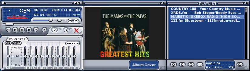

#2628 Today 15:52:41
Posts: 1,122
Audacious-stream-conky
Majestic Jukebox Radio ( Oldies )
The Mamas & The Papas  -  Dream a little dream of me
I completely forgot about this conky because I mostly listen to RadioTray-NG.
Audacious has a customized skin, and conky is in the middle.
First I created a background (with mtpaint) that looks like Audacious, and then thanks to a modified radiotray-ng script I got the album cover.
#2629 Today 17:14:03
Posts: 1,031
I've got a working Audacious Conky again when you click on it
It's been a while
conkyrc
    font = 'Liberation Sans:size=7',
    update_interval = 0.5,
    own_window_title = 'audacious_conky',
    minimum_width = 400,
    minimum_height = 100,
    text_buffer_size = 2048,
    default_color = 'white',
    alignment = 'bottom_middle',
    gap_x = 0,
    gap_y = 138,
    imlib_cache_size = 10000,
    out_to_stderr = false,
    lua_load = '~/.conky/lua/image.lua',
conky.text = [[${execi 0.2 bash /home/romuald/.conky/audacious/scripts/click_audacious.sh > /dev/null 2>&1}\
${execi 3 ~/.conky/audacious/scripts/cover.sh}
${goto 160}${execi 1 audtool current-song-output-length}  ${goto 358}${color ff8000}${execi 1 audtool current-song-length}\
${goto 188}${color ff8000}${execbar 2, 164 expr 100 \* $(audtool --current-song-output-length-seconds) \/ $(audtool --current-song-length-seconds)}$color\
${goto 188}${color 000000}${execbar 2, 164 echo 0}$color
${lua fDrawImage ~/.conky/audacious/audacious.png 24 14 68 70}\
${lua fDrawImage ~/.conky/audacious/case.png 0 0 410 108}\
${if_existing /tmp/audacious_click}${image /home/romuald/.conky/audacious/images/Orange.png -p 102,00 -s 30x30}${endif}\
${voffset -20}${font GE Inspira :size=10}\
${goto 160}${execi 3 audtool current-song-tuple-data artist}${font}
${goto 160}${execi 3 audtool current-song-tuple-data title}
${goto 160}${execi 3 audtool current-song-tuple-data album}
# AFFICHAGE DES ICÔNES (Configuration 4 boutons)
${lua fDrawImage ~/.conky/audacious/stop.png 115 31 13 13}
${lua fDrawImage ~/.conky/audacious/rew.png 100 45 13 13}
${lua fDrawImage ~/.conky/audacious/play.png 115 45 13 13}
${lua fDrawImage ~/.conky/audacious/fwd.png 130 45 13 13}
${voffset -250}
the script for clic & for the light
# 1. Récupération de la fenêtre
WINDOW_UNDER_MOUSE=$(xdotool getmouselocation --shell | grep WINDOW | cut -d= -f2)
WIN_NAME=$(xprop -id $WINDOW_UNDER_MOUSE WM_NAME 2>/dev/null | cut -d'"' -f2)
if [ "$WIN_NAME" != "audacious_conky" ]; then
    exit 0
# 2. Coordonnées relatives
WID=$(xdotool search --name "audacious_conky" | tail -1)
WX=$(xwininfo -id $WID | grep "Absolute upper-left X" | awk '{print $4}')
WY=$(xwininfo -id $WID | grep "Absolute upper-left Y" | awk '{print $4}')
eval $(xdotool getmouselocation --shell 2>/dev/null)
IS_DOWN=$(xinput query-state 16 | grep -o "button\[1\]=down")
REL_X=$((X - WX))
REL_Y=$((Y - WY))
if [ ! -z "$IS_DOWN" ]; then
    # On vérifie si on clique sur l'un des boutons
    # REW | PLAY | STOP | FWD
    if [[ $REL_X -ge 100 && $REL_X -le 113 && $REL_Y -ge 45 && $REL_Y -le 58 ]] || \
       [[ $REL_X -ge 115 && $REL_X -le 128 && $REL_Y -ge 45 && $REL_Y -le 58 ]] || \
       [[ $REL_X -ge 115 && $REL_X -le 128 && $REL_Y -ge 31 && $REL_Y -le 44 ]] || \
       [[ $REL_X -ge 130 && $REL_X -le 143 && $REL_Y -ge 45 && $REL_Y -le 58 ]]; then
        # Création du témoin lumineux
        touch /tmp/audacious_click
        # Exécution des commandes selon la zone
        [[ $REL_X -ge 100 && $REL_X -le 113 && $REL_Y -ge 45 && $REL_Y -le 58 ]] && audacious --rew
        [[ $REL_X -ge 115 && $REL_X -le 128 && $REL_Y -ge 45 && $REL_Y -le 58 ]] && audacious --play-pause
        [[ $REL_X -ge 115 && $REL_X -le 128 && $REL_Y -ge 31 && $REL_Y -le 44 ]] && audacious --stop
        [[ $REL_X -ge 130 && $REL_X -le 143 && $REL_Y -ge 45 && $REL_Y -le 58 ]] && audacious --fwd
        sleep 0.4
        rm -f /tmp/audacious_click
