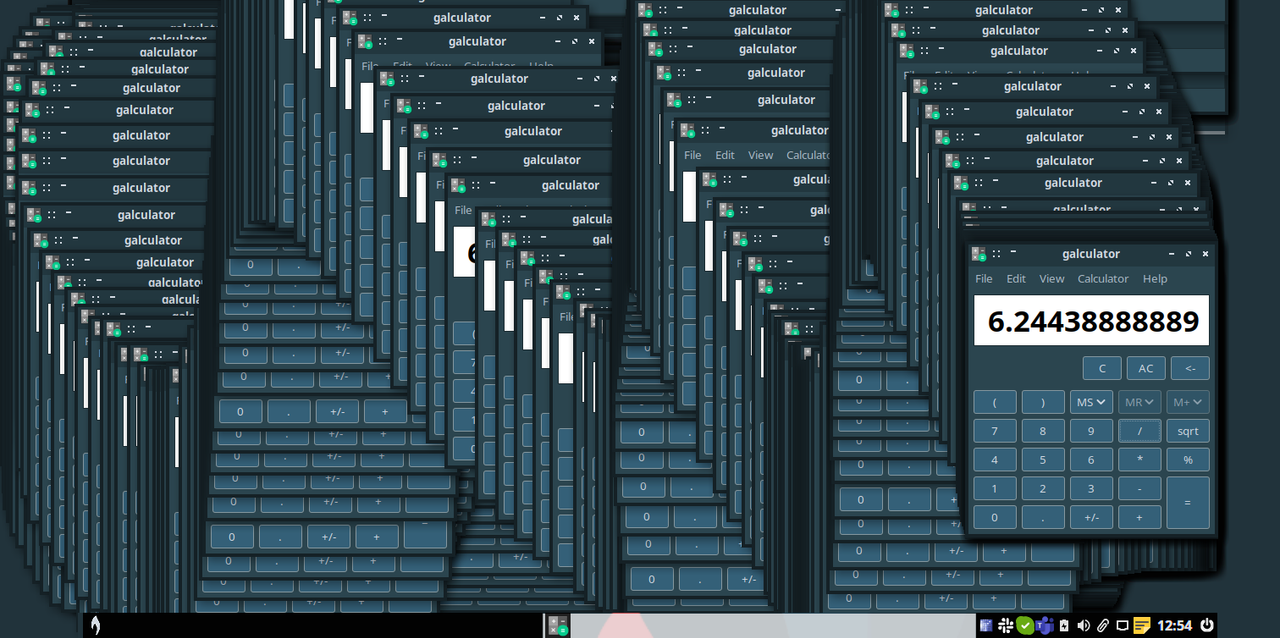

I am using Lithium on my Thinkpad x270 and I have a HP v185ws monitor connected via HDMI.
If I apply an RandR layout using an additional screen and I drag application windows around on that additional screen, then I see "trail" artefacts only on the second screen:
From a cold boot and logging in, providing the monitor is already connected via HDMI, I don't see any artefacts on the second display when dragging application windows around.
However, if I invoke the display layout via ARandR (GUI) or via the shell script that was created and saved for this display arrangement, then I see the artefacts.

Here are the scenarios.  I cannot identify any pattern in any of these results.
eDP-1 = Laptop LCD screen
DP-1 = Secondary HDMI screen
From power off, DP-1 is not connected:
eDP-1: no trailing
    DP-1 is connected:
    eDP-1: no trailing
    DP-1: no display
    ARandR layout for both displays is applied:
    eDP-1: trailing
    DP-1: trailing
From power off, DP-1 is already connected:
eDP-1: no trailing
DP-1: no trailing
    eDP-1: trailing
    DP-1: no trailing
    ARandR layout for DP-1 only is applied:
    DP-1: trailing
    DP-1 is disconnected:
    eDP-1: trailing
    ARandR layout for eDP-1 only is applied:
    eDP-1: no trailing

When a screen is added - switched from "not active" to "active" - the issue happens.
Whatever the wallpaper app Nitrogen does .. when applied to the faulty screen, the issue goes away.
#14 2020-11-30 07:00:55
Re: [Lithium] Graphics "trail" artefacts when using randr
This means that the root window (aka desktop) background remains undefined for some reason.
The trails affect only the background, not application windows.
Carefully (re-)configuring nitrogen should help, or use another background setter that knows how to deal with multiple monitors.
I can confirm that changing the wallpaper does workaround the issue.
