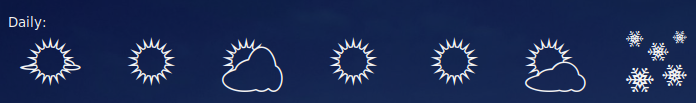

Open a terminal and run the script once:
bash ~/time_and_date_conky_script/tad
You will get a complete weather forecast for your location (Now, Daily, Hourly).
This is what it should look like:

#217 2025-12-28 00:16:40
Re: Conky Weather TAD script
Info
Added part #### WEATHERFONT.
Fans of the ConkyWeather and ConkyWindNESW fonts can test and make suggestions.
If necessary, I will set up the test_image  function within the TAD script.
Test conky (Daily/Hourly/Now+Wind):
Folders and images:
The script has been updated:
https://forums.bunsenlabs.org/viewtopic … 76#p147776

#220 2025-12-28 19:34:20
asqwerth wrote:
The conkyweather and conkywind font lines in the script appear to be working fine as far as I tell.  I compared the weather/wind font characters displayed (in a test conky) to the icons displayed in the tad conkies I'm already using.
Thanks for confirming.
I test by first running tad-conky,  and then test-conky  without the TAD script.
This test-conky  only displays data.
Text:
${voffset 10}${font conkyweather:size=50} ${texeci 600 sed -n '1p' $HOME/time_and_date_conky_script/weatherfont/daily} ${texeci 600 sed -n '2p' $HOME/time_and_date_conky_script/weatherfont/daily} ${texeci 600 sed -n '3p' $HOME/time_and_date_conky_script/weatherfont/daily} ${texeci 600 sed -n '4p' $HOME/time_and_date_conky_script/weatherfont/daily} ${texeci 600 sed -n '5p' $HOME/time_and_date_conky_script/weatherfont/daily} ${texeci 600 sed -n '6p' $HOME/time_and_date_conky_script/weatherfont/daily} ${texeci 600 sed -n '7p' $HOME/time_and_date_conky_script/weatherfont/daily}
${voffset 10} ${texeci 600 sed -n '1p' $HOME/time_and_date_conky_script/weatherfont/hourly} ${texeci 600 sed -n '2p' $HOME/time_and_date_conky_script/weatherfont/hourly} ${texeci 600 sed -n '3p' $HOME/time_and_date_conky_script/weatherfont/hourly} ${texeci 600 sed -n '4p' $HOME/time_and_date_conky_script/weatherfont/hourly} ${texeci 600 sed -n '5p' $HOME/time_and_date_conky_script/weatherfont/hourly}
${voffset 10} ${texeci 600 sed -n '1p' $HOME/time_and_date_conky_script/weatherfont/now}${font conkywindnesw:size=50} ${texeci 600 sed -n '1p' $HOME/time_and_date_conky_script/weatherfont/wind}\
${voffset 20}
Conkys:
Folders and images:
