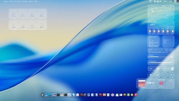

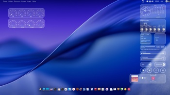

#2343 2025-08-10 19:59:23
Posts: 1,032
Day
Night
It's a shame that conky-clic no longer works; I could have done some interesting things with it..

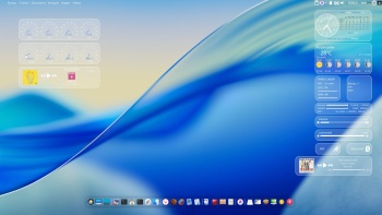

#2348 2025-08-12 12:15:07
Posts: 2,892
Day
https://thumbs2.imgbox.com/de/f2/99FgYB0w_t.png
Night
https://thumbs2.imgbox.com/2a/87/VwjczEtT_t.png
Avez-vous un exemple de clic conky? Je voudrais le tester.
Do you have an example of Conky-Click? I would like to test it.

#2350 2025-08-12 16:18:26
Posts: 1,032
Day
Night
