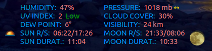

#4448 2024-02-28 17:13:09
Posts: 1,123
I finished the script that calculates moonduration.
You can test.
Open accuweather script.
Find line:
sed -i 's/--/N\/A/g' $HOME/Accuweather_conky_script/curr_cond
Add below:
#### SM*Settings 28.02.2024 - Moon Duration Script
moonrise=$(sed -n '25p' $HOME/Accuweather_conky_script/curr_cond)
moonset=$(sed -n '26p' $HOME/Accuweather_conky_script/curr_cond)
  if [[ "$moonrise" == "N/A"  || "$moonset" == "N/A" ]]; then
     printf "N/A" > $HOME/Accuweather_conky_script/moon_duration
## moonrise
moonrise_hour=$(sed -n '25p' $HOME/Accuweather_conky_script/curr_cond | awk -F':' '{print $1}')
moonrise_min=$(sed -n '25p' $HOME/Accuweather_conky_script/curr_cond | awk -F':' '{print $2}')
## moonset
moonset_hour=$(sed -n '26p' $HOME/Accuweather_conky_script/curr_cond | awk -F':' '{print $1}')
moonset_min=$(sed -n '26p' $HOME/Accuweather_conky_script/curr_cond | awk -F':' '{print $2}')
## convert to minutes
convert_moonrise=$(echo $moonrise_hour*60+$moonrise_min | bc)
convert_moonset=$(echo $moonset_hour*60+$moonset_min | bc)
## time2 - time1
diff=$(echo $convert_moonset-$convert_moonrise | bc)
if [[ $diff -ge 0 ]]; then
  diff1=$(echo $diff)
  diff1=$(echo 1440-${diff#-} | bc)
## back to hours
hours=$(echo $diff1 / 60 | bc)
hours1=$(echo $diff1 / 60 | bc -l)
## back to minutes
diff_min=$(echo $hours1-$hours | bc -l)
minutes1=$(echo $diff_min*60 | bc)
minutes=$(echo $minutes1 | awk '{print int($1)}')
#### Print Moon Duration
  if [[ $hours -ge 10 && $minutes -ge 10 ]]; then
     printf "$hours:$minutes" > $HOME/Accuweather_conky_script/moon_duration
  if [[ $hours -lt 10 && $minutes -lt 10 ]]; then
     printf "$hours:0$minutes" > $HOME/Accuweather_conky_script/moon_duration
  if [[ $hours -ge 10 && $minutes -lt 10 ]]; then
  if [[ $hours -lt 10 && $minutes -ge 10 ]]; then
#### END SM*Settings 28.02.2024 - Moon Duration Script
Conky:
MOON DURAT.: ${texeci 600 sed -n '1p' $HOME/Accuweather_conky_script/moon_duration}
Everything works as expected (for now).
We will see what happens when the moon is 'not available'.
Fixed a syntax error in the code.
EDIT 2
Fixed moonduration output.
Instead of (example) '9:2' > '9:02'.
EDIT 3
When the moon  rises/sets on the same day.
EDIT 4
The bug was found and fixed.

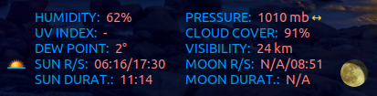

#4449 2024-03-02 00:34:47
Posts: 1,123
I didn't have to wait long to test the script when the moon 'not available'.
This happened just now ( for my location ).
The edited script (above) works.
Gis Weather:
Conky:
Accuweather site (my location):
