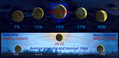

#4286 2023-07-22 02:26:20
Posts: 1,316
Moongiant conky script  -  Illumination Angle and Visibility in Real Time
I have successfully completed tonight script testing (whole moon cycle +) and everything is working as expected.
I added small aesthetic changes.
For example, now you have the option to make moon images look more yellow.
At the beginning of the script, I have described in more details how to determine the UTC correction for your location using the terminal.
Of course, you must first replace the latitude and longitude for your city instead Paris, France.
I will repeat (briefly) how to properly install the script:
Download the astronomy ZIP file from GitHub:

#### END Marens - Moon Illumination Angle and VisibilitY
#Resume weather conky
Restart conky.
Now the moon images is more yellow (default).
If you want to revert old images just add '#' before the second convert command and remove '#' before first convert command.
How to check if the script is working properly?
Visually, just wait night and look for the moon in the sky.
or
Visit:
https://www.timeanddate.com/astronomy/france/paris
In the search field, type your location and select it in the popup menu.
You will get a moon image for your location in real time.
It should be similar (same) as in conky.
The timeanddate site also gives the percentage of illumination in real time, so there may be small differences in the moon images.
Default moon (more yellow) images:
Old moon images:
Issues
Sometimes it can happen (not often) that the illumination_angle file looks like this:
Moon horizontal position: azimuth = 203.470, altitude = 14.310
Moon check: (1.00000000, 0.00000000, 0.00000000, 2023-06-08T14:20:00.000Z)
Excessive error in moon check (y).
The reason is tolerance.
At the beginning of the camera.py script:
def Camera(observer, time):
    tolerance = 1.0e-15
and next:
if abs(vec.x - 1.0) > tolerance:
        print("Excessive error in moon check (x).")
        return 1
    if abs(vec.y) > tolerance:
        print("Excessive error in moon check (y).")
        return 1
    if abs(vec.z) > tolerance:
        print("Excessive error in moon check (z).")
        return 1
When this 'error' occurs, we get the old 'vertical' moongiant images without illuminations angle.
After a few minutes (next conky update), everything works (again) as expected.
Any question?
More details about visibility and illumination_angle files and how to use them in conky in my old post:
https://forums.bunsenlabs.org/viewtopic … 12#p127912
#4287 2023-07-23 13:28:34
Posts: 1,316
I forgot to post a simple MoonReal test conky.
Configuration is usual, just set minimum_size 200 0.
${texeci 500 bash $HOME/Moongiant_conky_script/moongiant}${voffset 5}${alignc}${color gold}${texeci 600 date +%R}
${if_match "${texeci 600 sed -n '1p' $HOME/Moongiant_conky_script/visibility}" == "Under Horizon"}${color A40000}${voffset 50}${alignc}${texeci 600 sed -n '1p' $HOME/Moongiant_conky_script/visibility}${voffset -50}${else}${endif}
${voffset 100}${alignc}${color 0098FF}altitude:  ${color FF6060}${texeci 600 cat $HOME/Moongiant_conky_script/illumination_angle | grep -oP '(?<=altitude = )[^ ]*'}°
${alignc}${color 0098FF}azimuth:  ${color FF6060}${texeci 600 cat $HOME/Moongiant_conky_script/illumination_angle | grep -oP '(?<=azimuth = )[^ ]*' | awk -F',' '{print $1}'}°${voffset 5}\
${image $HOME/Moongiant_conky_script/0.png -p 60,45 -s 80x80}
Moon Altitude is the vertical angle the Moon makes with the horizon.
When Atitude < 0 Moon is Under Horizon (Invisible).
Moon Azimuth is specified as the horizontal angle the object makes with a reference direction, such as true north.
More details:
https://www.timeanddate.com/astronomy/h … ystem.html

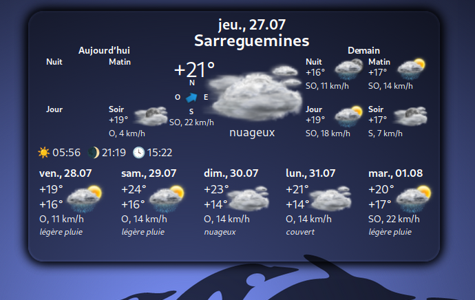

#4289 2023-07-27 14:36:28
Thanks for the sha256. Great service!
The result:
I personally like the old version better   wink
Another question. I tried to enlarge the wind icon. It could be bigger for my taste. Unfortunately the script doesn't seem to accept it. So, it does not change.
#4290 2023-07-27 15:11:45
Posts: 1,316
The result:
https://i.imgur.com/PBY10uQt.png
It seems that your system font does not support the new characters properly.
Wind icon
Open gis-weather.py file:
Find this part:
               if icon_wind_now[0] != 'None':
                    self.draw_scaled_image(cr, x0-a/2+font_NS/2, y0-a/2+3+font_NS/2, self.find_icon('wind'), a, a, icon_wind_now[0]+angel)
Replace with:
                    a = 48
Edit
I am currently testing with a = 44.
It's a bit smaller wind icon than a = 48, but it looks better to me.
With wind icon (a = 44):

#4293 2023-07-28 08:58:50
You were right, it looks better at 44.  wink
@marens, thanks for your help! I have appreciated this very much.
