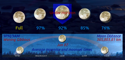

#4247 2023-06-07 13:46:03
Posts: 1,123
Moongiant conky script  -  Illumination Angle and Visibility in Real Time
I know that it is an 'impossible mission' (for us) to calculate the exact illumination angle.
Astronomy is a serious science with many variable dependencies.
Yes, but some know better than us.
We need an illumination angle and visibility in real time.
I decided to investigate it, and found site timeanddate.com.
Good News
After many days I managed to find a solution for illumination angle.
I only need two variables, from timeanddate.com.
But at the last moment I saw:
timeanddate.com wrote:
Scripts and programs that download content transparent to the user are not allowed without permission.
"Houston, we have a problem!"
What to do now?
Bad News
I contacted the timeanddate.com team and sent the part of my script relates to them, but:
Please do not run this script on our site. We have an Astronomy API available for you to access information from our databases; you can read about our APIs here:
https://dev.timeanddate.com/astro/pricing
I visited the link.
Of course, they want money - a lot of money per the year($499).
I had to thank them and wish luck in their future work and:
My script will not be published anywhere.
I will try to get those two necessary data elsewhere.
Questions for discussion and @mods
  • Are curl, wget commands legal and when?
  • If it is the same as Save Page As from browser, what is the problem?
  • What is commercial use?
But, does not matter.
I never didn't give up.
And month later, I found:
https://github.com/cosinekitty/astronomy.
Nothing was clear to me, but I decided to see what was there a little better.
The best way is to look at the closed issues and I found this:
https://github.com/cosinekitty/astronomy/issues/292
I thought, this might be useful, let's give it a try.
Downloaded the astronomy ZIP file from GitHub and extract astronomy-master folder in Moongiant_conky_script.
Then, I had to make changes to the moongiant file.
*If someone uses my old changes delete this:
https://forums.bunsenlabs.org/viewtopic … 17#p126817
Add my new script before last line (#Resume weather conky):
#### Marens - Moon Illumination Angle and VisibilitY
#Example: Paris, France
#Replace to your city latitude, longitude
latitude=48.864716
longitude=2.349014
#Convert Time to Zulu (UTC)
#My current Time is CEST with daylight saving time - UTC+2
#Missing correction -2 hours to UTC
#More details: www.techtarget.com/whatis/definition/Zulu-Zulu-time
#It's important to note that these will change in regions that observe daylight saving time in the summertime.
#Correction -2 hours (without daylight saving time -1 hour)
date=$(date -d '-2 hour' '+%Y-%m-%dT%H:%M:%SZ')
#Start python script
python3 $HOME/Moongiant_conky_script/astronomy-master/demo/python/camera.py $latitude $longitude $date > $HOME/Moongiant_conky_script/illumination_angle
#Moon Illumination Angle and Moon Visibility (Visible/Under Horizon)
rotation=$(cat $HOME/Moongiant_conky_script/illumination_angle | grep -oP '(?<=Moon = )[^ ]*' | awk -F'.' '{print $1}')
altitude=$(cat $HOME/Moongiant_conky_script/illumination_angle | grep -oP '(?<=altitude = )[^ ]*' | awk -F'.' '{print $1}')
#Illumination Angle
if [[ $rotation -ge 0 ]]; then
  illumination_angle=$(echo 90-$rotation | bc)
  #rotation absolute value
  illumination_angle=$(echo ${rotation#-}-90 | bc)
#Control
#echo $rotation
#echo $altitude
#echo $illumination_angle
#Visibility
if [[ $altitude -ge 0 ]]; then
  echo 'Visible' > $HOME/Moongiant_conky_script/visibility
  echo 'Under Horizon' > $HOME/Moongiant_conky_script/visibility
#Images
for szFile in $HOME/Moongiant_conky_script/*.png
    convert "$szFile" -background 'none' -virtual-pixel 'none' -distort SRT $illumination_angle $HOME/Moongiant_conky_script/"$(basename "$szFile")" ;
Save text editor and restart moongiant conky.
Now, we have two new files in the Moongiant_conky_script folder.
Illumination_angle with additional data and visibility - indicating when the moon is visible/under on horizon.
You can add new lines in moongiant conky (if you wish).
I only interested if the moon is Under Horizon.
From my conky:
${if_match "${texeci 600 sed -n '1p' $HOME/Moongiant_conky_script/visibility}" == "Under Horizon"}${texeci 600 sed -n '1p' $HOME/Moongiant_conky_script/visibility}${else}${endif}
Now, moon in conky looks same as on my 'favorite' site timeanddate.com and in the sky.
You will be surprised to see how much the moon changes during the day depending on the position of the sun and the earth.
Now this conky isn't 'boring' (same all day).
I don't have a GitHub account, but many thanks @cosinekitty (author of astronomy) user.
Also, many thanks timeanddate.com team for 'helping' me learn a lot about moon and his orbit around the sun and earth.
New script version:
https://forums.bunsenlabs.org/viewtopic … 46#p128546
