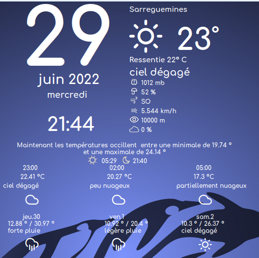

#1704 2022-06-29 20:00:26
Posts: 1,032
Here my openweathermap conky with my Free API key
i modify the "Alfirk conky" & i added a few script (10) in total That are 11 scripts who are running
- wind scripts (2)
- hours scripts (4)
- days scripts  (4)
as we say in our region " c'est une vrai usine @ gaz"  "it's a real gas factory " & the best is that for my fisrt conky with raw data & jq i have no errors in terminal.
I think that a great conkystador master could simplify it a lot.
Voila.

${goto 15}${font Abel:size=11}${execpi 600 cat ~/.cache/weather.json | jq -r '.weather[0].description' | sed "s|\<.|\U&|g"}
${voffset -50}${goto 120}${font Bebas Neue:size=18}${execpi 600 (cat ~/.cache/weather.json | jq -r '.main.temp' | awk '{print int($1+0.5)}')}°${goto 185}${font feather:size=60}${execpi 600 ~/.conky/loutch/weather-text-icon}
${voffset -90}${goto 15}${font Abel:size=8}Wind speed :${image ~/.conky/loutch/icons/wind.png -p 90,60 -s 19x19}${goto 120}${execpi 600 (cat ~/.cache/weather.json | jq '.wind.speed')} m/s
${goto 15}Wind gust :${image ~/.conky/loutch/icons/wind-2.png -p 90,75 -s 20x20}${goto 120}${execpi 600 (cat ~/.cache/weather.json | jq '.wind.gust')} m/s
${goto 15}Wind deg :${image ~/.conky/loutch/icons/wind_rose-2.png -p 90,92 -s 18x18}${goto 120}${execpi 600 (cat ~/.cache/weather.json | jq '.wind.deg')} °${goto 160}${execpi 600 $HOME/.conky/loutch/weather-wind-dir}
${goto 15}Humidity :${image ~/.conky/loutch/icons/humidity.png -p 90,107 -s 19x19}${goto 120}${execpi 600 (cat ~/.cache/weather.json | jq '.main.humidity')} %
${goto 15}sunrise :${image ~/.conky/loutch/icons/sunrise.png -p 90,125 -s 18x18}${goto 120}${execpi 600 date -d "@$(jq -r .sys.sunrise ~/.cache/weather.json)" +%H:%M\ %P}
${goto 15}sunset :${image ~/.conky/loutch/icons/sunset.png -p 90,142 -s 18x18}${goto 120}${execpi 600 date -d "@$(jq -r .sys.sunset ~/.cache/weather.json)" +%H:%M\ %P}
${goto 15}Clouds :${image ~/.conky/loutch/icons/clouds.png -p 90,157 -s 18x18}${goto 120}${execpi 600 (cat ~/.cache/weather.json | jq -r '.clouds.all')} %
${goto 15}Pressure :${image ~/.conky/loutch/icons/pressure.png -p 90,173 -s 18x18}${goto 120}${execpi 600 (cat ~/.cache/weather.json | jq -r '.main.pressure')} mb
${goto 15}Visibility :${image ~/.conky/loutch/icons/visibility.png -p 90,190 -s 18x18}${goto 120}${execpi 600 (cat ~/.cache/weather.json | jq -r '.visibility')} m${font}
${voffset -75}
and, fun with it.  smile

Guys i made a same script to have wind direction & wind speed in km/h .
# Modifié par Loutch le 27-05-22
rm $HOME/.conky/Alfirk/vent
deg=$(jq --raw-output '.wind.deg' $HOME/.conky/Alfirk/raws/rawcurrent)
  # N 348.75 - 11.25
  if [[ "${deg}" -ge 348 ]] || [[ "${deg}" -le 11 ]];  then
    echo "N" > $HOME/.conky/Alfirk/vent
  # NNE 11.25 - 33.75
  elif [[ "${deg}" -gt 11 ]] && [[ "${deg}" -lt 34 ]];  then
    echo "NNE" >> $HOME/.conky/Alfirk/vent
  # NE 33.75 - 56.25
  elif [[ "${deg}" -ge 34 ]] && [[ "${deg}" -lt 56 ]]; then
    echo "NE" >> $HOME/.conky/Alfirk/vent
  # ENE 56.25 - 78.75
  elif [[ "${deg}" -ge 56 ]] && [[ "${deg}" -lt 78 ]]; then
    echo "ENE" >> $HOME/.conky/Alfirk/vent
  # E 78.75 - 101.25
  elif [[ "${deg}" -ge 78 ]] && [[ "${deg}" -lt 101 ]]; then
    echo "E" >> $HOME/.conky/Alfirk/vent
  # ESE 101.25 - 123.75
  elif [[ "${deg}" -ge 101 ]] && [[ "${deg}" -lt 123 ]]; then
    echo "ESE" >> $HOME/.conky/Alfirk/vent
  # SE 123.75 - 146.25
  elif [[ "${deg}" -ge 123 ]] && [[ "${deg}" -lt 146 ]]; then
    echo "SE" >> $HOME/.conky/Alfirk/vent
  # SSE 146.25 - 168.75
  elif [[ "${deg}" -ge 146 ]] && [[ "${deg}" -lt 168 ]]; then
    echo "SSE" >> $HOME/.conky/Alfirk/vent
  # S 168.75 - 191.25
  elif [[ "${deg}" -ge 168 ]] && [[ "${deg}" -lt 191 ]]; then
    echo "S" >> $HOME/.conky/Alfirk/vent
  # SSW 191.25 - 213.75
  elif [[ "${deg}" -ge 191 ]] && [[ "${deg}" -lt 213 ]]; then
    echo "SSO" >> $HOME/.conky/Alfirk/vent
  # SW 213.75 - 236.25
  elif [[ "${deg}" -ge 213 ]] && [[ "${deg}" -lt 236 ]]; then
    echo "SO"  >> $HOME/.conky/Alfirk/vent
  # WSW 236.25 - 258.75
  elif [[ "${deg}" -ge 236 ]] && [[ "${deg}" -lt 258 ]]; then
    echo "OSO" >> $HOME/.conky/Alfirk/vent
  # W 258.75 - 281.25
  elif [[ "${deg}" -ge 258 ]] && [[ "${deg}" -lt 281 ]]; then
    echo "O" >> $HOME/.conky/Alfirk/vent
  # WNW 281.25 - 303.75
  elif [[ "${deg}" -ge 281 ]] && [[ "${deg}" -lt 303 ]]; then
    echo "ONO" >> $HOME/.conky/Alfirk/vent
  # NW 303.75 - 326.25
  elif [[ "${deg}" -ge 303 ]] && [[ "${deg}" -lt 326 ]]; then
    echo "NO" >> $HOME/.conky/Alfirk/vent
  # NNW 326.25 - 348.75
  elif [[ "${deg}" -ge 326 ]] && [[ "${deg}" -lt 348 ]]; then
    echo "N/A"
num1=$(jq --raw-output '.wind.speed' $HOME/.conky/Alfirk/raws/rawcurrent)
num2=3.6
ans=$(bc -l <<<"$num1*$num2")
echo $ans >> $HOME/.conky/Alfirk/vent
Here in conky
${offset 150}${voffset 4} ${execi 590 sed -n '1p' $HOME/.conky/Alfirk/vent}
${offset 150}${voffset 4} ${execi 600 sed -n '2p' $HOME/.conky/Alfirk/vent | awk '{print int($1+0.5)}'} km/h
here my vent file
N          "wind direction"
11.124  "wind speed in km/h
