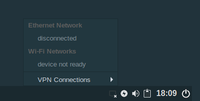

The one annoying issue I have is, after installing my BunsenLabs packages, the nm-applet is reporting "device not ready", just as reported by the OP in this topic.
I could manually setup the wireless network by using `raspi-config`.  Through an NCurses menu, I just had to enter the SSID and the passphrase.
But even when the Wi-Fi is correctly setup and working, the nm-applet still reports 'device not ready'.
Other than that, everything is working well.
