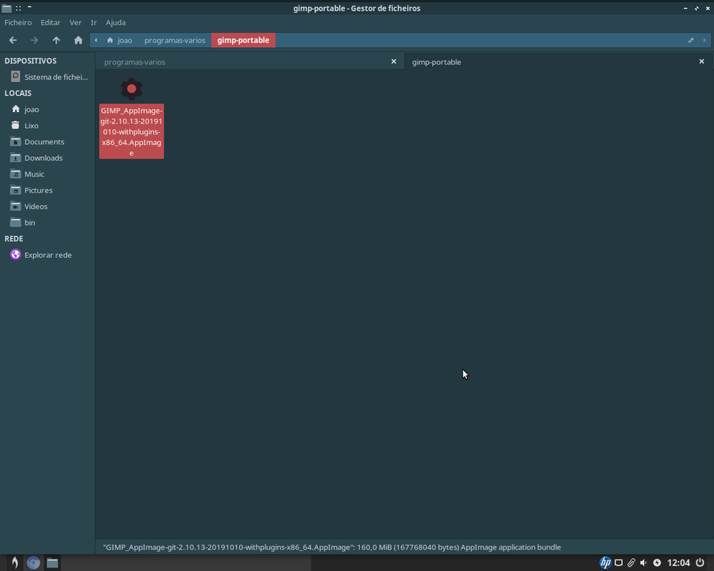

I download Gimp-appimage from here → https://appimage.github.io/GIMP/,
and G'MIC works if I launch Gimp-appimage program, so I think that the problem is in relation with the package of Gimp in the repositories of Debian.

Now I have two entries of gimp on my menu How I can change the name of one to know what is the software that runs G'MIC and that not?
Where is the place to edit names of software installed and that appear on menu ?
