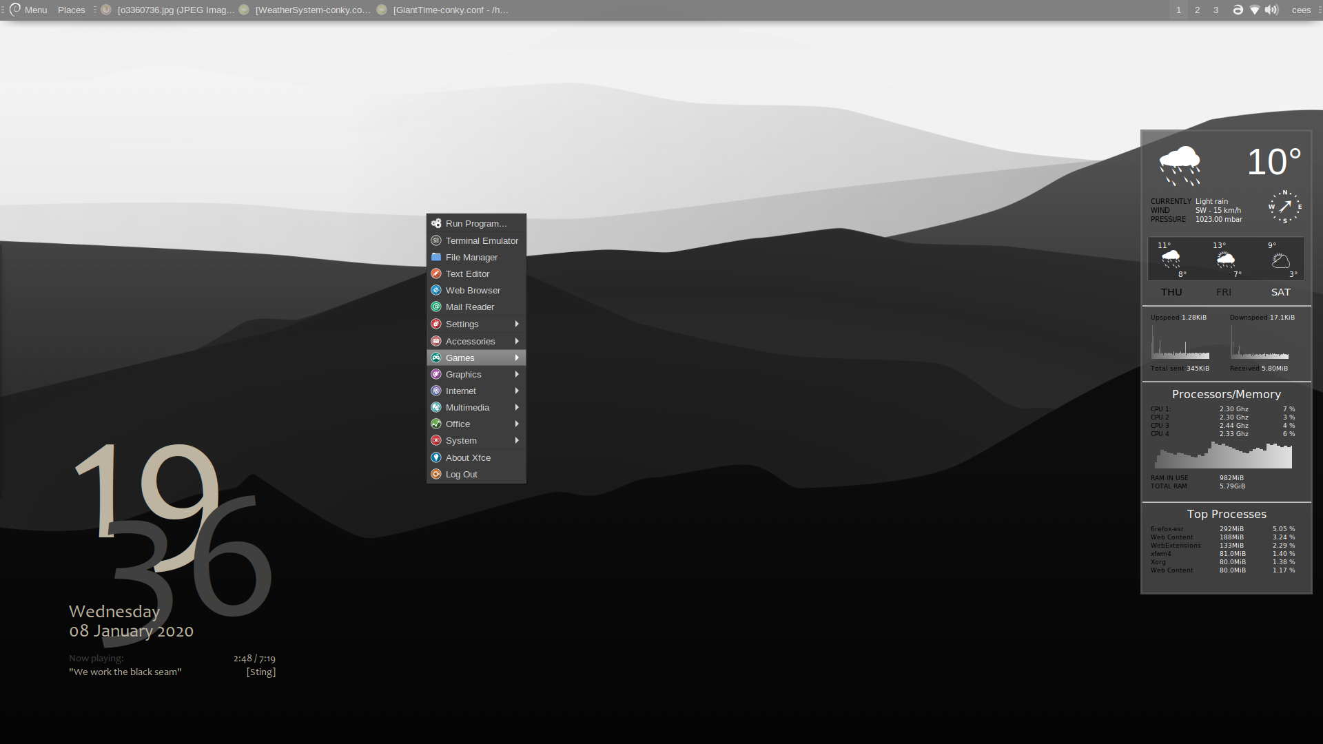

the clock
conkyrc

conky.text = '';conky_clock.lua
-- Пример написания скрипта часов

endthe conky with the accuweather
conkyrc

unklar wrote:Conky adapted to Lithium
2020-01-06-14-09-11_scrot.th.pngHappily used the conky,conf code that unklar provided ^
Changed it to my liking into a semi-transparent greyscale version.
https://thumbs2.imgbox.com/2b/54/ks6vUHhK_t.png
Would you happen to still have this? Particularly, the conky script at the botton on the left, looks dope mate.
Here's the config for 'GiantTime' conky:
-- Giant-time --
update_interval = 1,
net_avg_samples = 1,
cpu_avg_samples = 1,
imlib_cache_size = 0,
own_window_type = 'desktop',
own_window_argb_value = 0,
own_window_hints = 'undecorated,below,sticky,skip_taskbar,skip_pager',
own_window_class = 'Conky',
own_window_title = 'ConkyGiantTime',
border_inner_margin = 5,
border_width = 10,
font = 'candara:size=12',
text_buffer_size = 2048,
xftalpha = 0.9,
short_units = true,
text_buffer_size = 800,
-- use_spacer = 'right',
alignment = 'bottom_left',
gap_x = 120,
gap_y = 80,
minimum_width = 300,
minimum_height = 0,
-- maximum_width = 360,
-- color1 = 'FFFFFF', -- white
color1 = 'BDB5A1', -- very lightgrey
-- color1 = '808080', -- lightgrey
-- color1 = '606060', -- grey
-- color1 = '404040', -- darkgrey
-- color1 = '202020', -- darkest grey
-- color1 = '101010', -- blackish
-- color1 = '000000', -- black
-- color1 = 'CDB17E', -- pale yellow
-- color2 = 'FFFFFF', -- white
-- color2 = 'BDB5A1', -- very lightgrey
-- color2 = '808080', -- lightgrey
-- color2 = '606060', -- grey
color2 = '404040', -- darkgrey
-- color2 = '202020', -- darkest grey
-- color2 = '101010', -- blackish
-- color2 = '000000', -- black
-- color2 = 'B13900', -- orange
-- color2 = 'AC1E1A', -- darkreddish
-- color2 = '2B3446', -- '045C60', -- '5A8A8A', -- darkblue
-- color2 = '6CA590', -- lightblue
-- color2 = 'F3A600', -- yellow
-- color2 = '3F2147', -- purple
-- color2 = '5294E2', -- '1F6F8A', -- blue
-- color3 = 'FFFFFF', -- white
-- color3 = 'BDB5A1', -- very lightgrey
-- color3 = '808080', -- lightgrey
-- color3 = '606060', -- grey
-- color3 = '404040', -- darkgrey
color3 = '202020', -- darkest grey
-- color3 = '101010', -- blackish
-- color3 = '000000', -- black
-- color3 = 'B13900', -- orange
-- color3 = 'AC1E1A', -- darkreddish
-- color3 = '2B3446', -- '045C60', -- '5A8A8A', -- darkblue
-- color3 = '6CA590', -- lightblue
-- color3 = 'F3A600', -- yellow
-- color3 = '3F2147', -- purple
-- color3 = '1F6F8A', -- blue
### Hour
${voffset -30}${font candara:size=194}${color1}${time %H}
### Minute
${voffset -150}\
${alignc}${offset 24}${color2}${time %M}
### Day & Date
${voffset -250}\
${font candara:size=20}${voffset -4}${color1}${time %A}
${time %d %B %G}${font}
### Audacious (if running)
${voffset 20}\
${if_running audacious}${color3}Now ${exec audtool --playback-status}: \
${alignr}${color1}${exec audtool --current-song-output-length} / ${exec audtool --current-song-length}
${voffset 4}"${exec audtool --current-song-tuple-data title}" \
${alignr}[${exec audtool --current-song-tuple-data artist}]${endif}${voffset -100}
]];Offline
ceeslans wrote:
A header saying "Click to proceed to image" or some such. Doesn't work without javascript of course.
The page source gave me a direct image link:
https://images2.imgbox.com/2b/54/ks6vUHhK_o.png
Nice conky.
bry2k200 wrote:Would you happen to still have this? Particularly, the conky script at the botton on the left, looks dope mate.
---------------- -- Giant-time -- ---------------- conky.config = { update_interval = 1, total_run_times = 0, net_avg_samples = 1, cpu_avg_samples = 1, imlib_cache_size = 0, double_buffer = true, no_buffers = true, own_window = true, own_window_type = 'desktop', own_window_argb_visual = true, own_window_argb_value = 0, own_window_hints = 'undecorated,below,sticky,skip_taskbar,skip_pager', own_window_class = 'Conky', own_window_title = 'ConkyGiantTime', border_inner_margin = 5, border_width = 10, use_xft = true, font = 'candara:size=12', override_utf8_locale = true, text_buffer_size = 2048, uppercase = false, xftalpha = 0.9, draw_shades = false, short_units = true, text_buffer_size = 800, -- use_spacer = 'right', alignment = 'bottom_left', gap_x = 120, gap_y = 80, minimum_width = 300, minimum_height = 0, -- maximum_width = 360, -- color1 = 'FFFFFF', -- white color1 = 'BDB5A1', -- very lightgrey -- color1 = '808080', -- lightgrey -- color1 = '606060', -- grey -- color1 = '404040', -- darkgrey -- color1 = '202020', -- darkest grey -- color1 = '101010', -- blackish -- color1 = '000000', -- black -- color1 = 'CDB17E', -- pale yellow -- color2 = 'FFFFFF', -- white -- color2 = 'BDB5A1', -- very lightgrey -- color2 = '808080', -- lightgrey -- color2 = '606060', -- grey color2 = '404040', -- darkgrey -- color2 = '202020', -- darkest grey -- color2 = '101010', -- blackish -- color2 = '000000', -- black -- color2 = 'B13900', -- orange -- color2 = 'AC1E1A', -- darkreddish -- color2 = '2B3446', -- '045C60', -- '5A8A8A', -- darkblue -- color2 = '6CA590', -- lightblue -- color2 = 'F3A600', -- yellow -- color2 = '3F2147', -- purple -- color2 = '5294E2', -- '1F6F8A', -- blue -- color3 = 'FFFFFF', -- white -- color3 = 'BDB5A1', -- very lightgrey -- color3 = '808080', -- lightgrey -- color3 = '606060', -- grey -- color3 = '404040', -- darkgrey color3 = '202020', -- darkest grey -- color3 = '101010', -- blackish -- color3 = '000000', -- black -- color3 = 'B13900', -- orange -- color3 = 'AC1E1A', -- darkreddish -- color3 = '2B3446', -- '045C60', -- '5A8A8A', -- darkblue -- color3 = '6CA590', -- lightblue -- color3 = 'F3A600', -- yellow -- color3 = '3F2147', -- purple -- color3 = '1F6F8A', -- blue }; conky.text = [[ ### Hour ${voffset -30}${font candara:size=194}${color1}${time %H} ### Minute ${voffset -150}\ ${alignc}${offset 24}${color2}${time %M} ### Day & Date ${voffset -250}\ ${font candara:size=20}${voffset -4}${color1}${time %A} ${time %d %B %G}${font} ### Audacious (if running) ${voffset 20}\ ${if_running audacious}${color3}Now ${exec audtool --playback-status}: \ ${alignr}${color1}${exec audtool --current-song-output-length} / ${exec audtool --current-song-length} ${voffset 4}"${exec audtool --current-song-tuple-data title}" \ ${alignr}[${exec audtool --current-song-tuple-data artist}]${endif}${voffset -100} ]];
Thanks a bunch!
