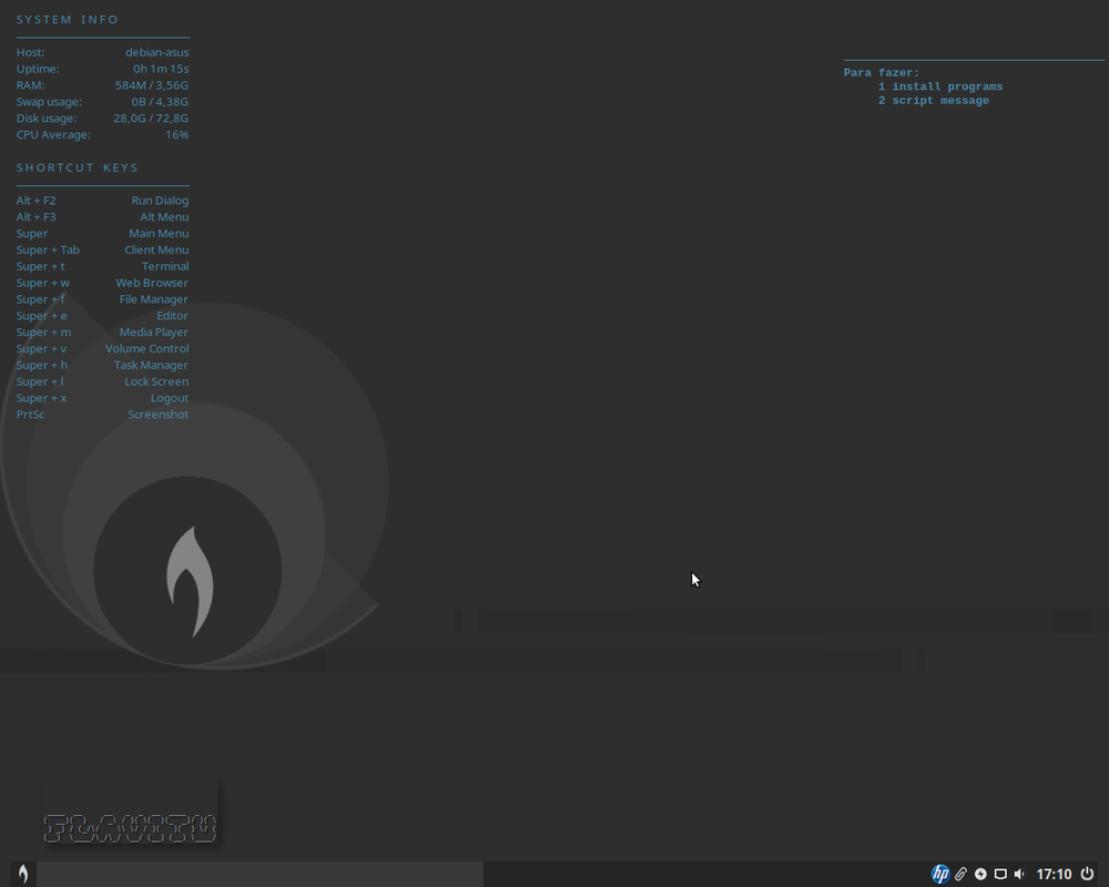

Script welcome message on autostart dont work.[solved]
In past I use a distro called Gobang Linux that is very similar to Bunsenlabs, it also uses Openbox.
I this distro we have a message script welcome at each time that we start session on pc.
The site of distro.
https://gobangos.sourceforge.io/
So from this date I allways use this script to put a derivative on my instalaltions, I iinstall xdotool and aosd-cat as dependencies to make the scritp work, I do the same work on Bunsenlabs but for some reason doesn't work.
The script :
asd() {
cat <<"EOT"
 ____  __     __   _  _  __  ____  _  _
(  __)(  )   / _\ / )( \(  )(_  _)/ )( \
 ) _) / (_/\/    \\ \/ / )(   )(  ) \/ (
(__)  \____/\_/\_/ \__/ (__) (__) \____/
EOT
asd  | aosd_cat -n "Monospace 6"  -R "#ABB3C6" -B None -S black -t 2 -f 500 -u 4500 -o 500  -p 6 -l 0 -s 192 -r 255
echo | aosd_cat -n "Monospace 8"  -R "#9f9f9f" -B None -S black -t 2 -f 500 -u 16000 -o 500  -p 6 -l 0 -s 192 -r 255
I think that have any differente method to work with .sh files on Bunsenlabs generally because I have some .sh files that simple dont work when  click on her icon and simply runs geany a open the files, I had markd previously to "make this file executable on settings of file on thunar".
But if I open the terminal on the path of the script and run them from terminal with :
→ $ sh mensagem.sh
it works and appear on desktop.
Maybe someone have an idea to make this work put the file on /.config/autostart to appear at any time that we start our session on pc.

It works but need to put the following line on the autostart file placed in ./config/bunsen/autostart
## mensagem log-in
sh /home/joao/.config/autostart/mensagem.sh &
