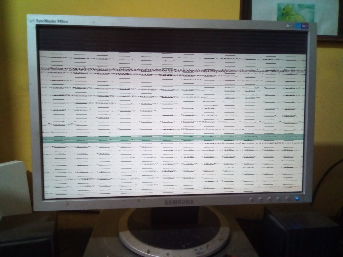

I bought a new motherboard (AMD Prime A320M-K) so I am trying to install Bunsenlabs Helium (amd64) from de live CD, but I only see this on my screen after executing "Install":
This doesn't happen if I execute a live session or if I try to install Bunsenlabs Hydrogen. I don't really know what's the problem? sad

Most probably it is a problem with video. I think the solution will be adding something in grub, but before we have to know which graphics card you have.
Please, boot once more the live session, open terminal and execute
lspci -nn | egrep -i "3d|display|vga"
and post output here (inside the 'Code' tag)

BUT - a search for "[AMD/ATI] Device [1002:15dd]" seems to indicate that you might benefit from a backported kernel.
ok, you need to install BL first.
does it have a fallback (not recovery) boot option? can you try a non-graphical install?
if not, you have to edit the kernel command line and add "nomodeset" (without the quotes).

i guess your hardware is too new.

Well, I did a test: I connected the old motherboard and the installer of Helium runs fine. So... what if I use the old motherboard to install Helium, update the kernel to the lastest version, and then connect the new motherboard? Should this work?

It should work...just make sure you update to latest kernel post-installation.
