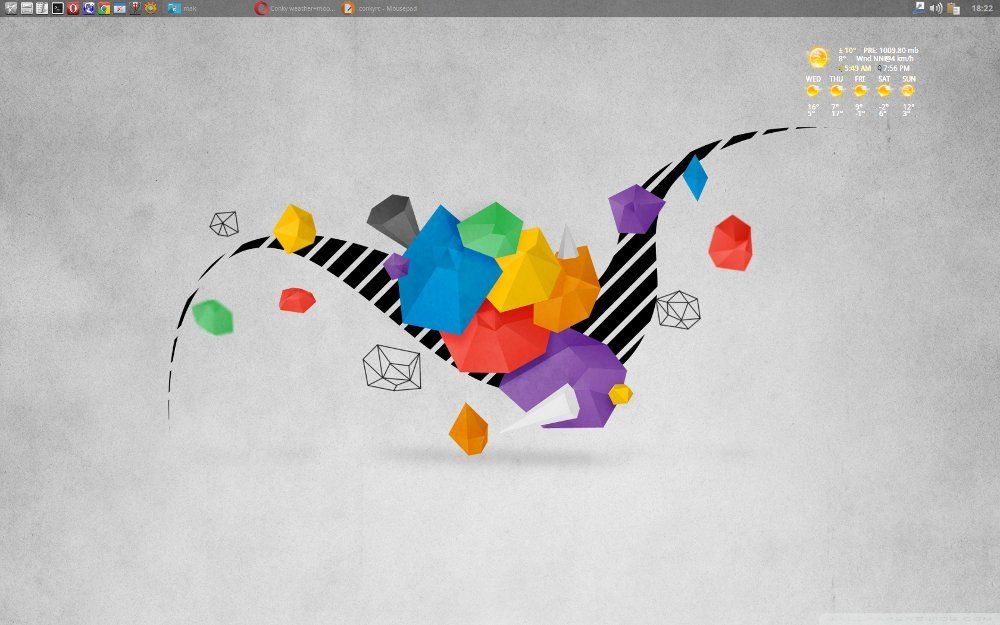

Hello,
I've found this really nice weather conky on this forum, but it is super tiny.
I would like to make it bigger, at least double or triple.
I've already tried to increase the
minimum_size 230 145     ## width, height
maximum_width 230    ## width, usually a good idea to equal minimum width
but it has no impact.
This is a screenshot to see how tiny it is.
https://photos.google.com/photo/AF1QipO … XvJaJt10My
This is my .conkyrc file

Now, that I changed the window_transparency to no, I see that the window indeed changed but all info inside remained the same - text, images everything. If I change the size of the text say 12, it overlaps the images because the images remain the same.
How can I change the size of the images?

jmak wrote:
@jmak
Easiest way to change the size:  [Alt]+F2
mirage /path/to/the_image/ragamatrix_weather_t.png
in mirage: Edit » Resize (make sure you preserve the aspect ratio)
http://s20.postimg.org/jqirtxbd5/2016_04_26_21_01_06_Scrot11.jpg
Whatever you change the size to ... make these:
minimum_size 230 145  ## w|h
'at least' the size of the image - not smaller
I cannot find the "ragamatrix_weather_t.png" image. It is not in the "1b1_accuweather_images/Forecast_Images" folder!

Oh he fixed that - took the shortcut you posted: own_window_transparent no
We've moved on ... the conky I know ... it's mine.  big_smile
You can always tell it's mine if you see: /media/5/Conky/ in the first line:
# pkill -xf "conky -q -c /media/5/Conky/ragamatrix_weather.conky" &

This works fine, only it is too tiny.
I just need to make it bigger.

So, how can I make it larger?

The other one now, seems to work.
I posted a screenshot and the .conkyrc file.
