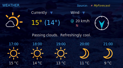

I just finished mf-conky.
It takes time to complete testing, but so far everything looks good.
This conky is based on my  tad-conky:
https://forums.bunsenlabs.org/viewtopic … 40#p149340
As you know, I use the old syntax/format and share with you only text.
If you want, you can test with me.
You need to set in the configuration:
1) text_buffer_size 1024
2) minimum_size 460 0

This is how it looks in Conky:
No Wind (Calm)
I expected that to happen, but I didn't know what it looked like on the website.
As you can see, the wind speed is 0 km/h, but the wind direction (N) is still shown.

Testing MyForecast Conky
Testing is complete.
Everything works as expected.
If special cases arise, take a screenshot and display the contents of the corresponding file (now, phrase, images...).
Enjoy.  smile

MyForecast Icons
The original mf-icons look great.
I think the moon icon 13.png (Clear) is too big and moved up.
I made it smaller and better centered using Inkscape.
Then I checked how it looks in conky.
The icon  hourly_3.png  (03:00) has been simulated to examine the alignment
If you like it, you can download the new icon 13.png here:
https://i.postimg.cc/ZnjXPCM9/13.png
Rename the old icon 13.png to 13_orig.png, then just copy/paste the new one into the  myforecast-icons  folder.
