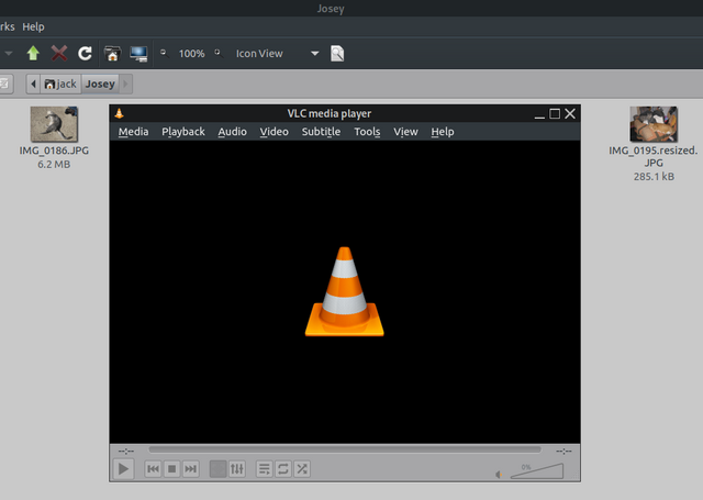

greenjeans wrote:
...installed the qt5gtk2 package for Debian testing from unit193's repo on the opensuse build service. Works fine, also installed the qt6gtk2 package for trixie that HOAS made and confirmed they both work off the same export command in ~/.xsessionrc: export QT_QPA_PLATFORMTHEME=qt5gtk2.
So for Carbon we should have qt5gtk2 and qt6gtk2 available and installed, and set that environment variable. That advice still stands? If so, I should clone the code and rebuild the packages for our repo.
I think so. But it should be tested of course, I will try later in a live-session, but they worked great on Trixie when I tried them.
One thing though which I don't have Carbon running right now so I don't know, is does it have some qt5 and/or qt6 apps installed? I haven't put the qt6 version in my projects because no qt6 apps are installed, and installing the qt6gtk2 package requires some qt6 libraries to be installed. So I left it out but made the option available in a separate package.
The only qt5 app in my projects is VLC, so the libraries are already installed and it does a nice number on VLC.
And as I mentioned, the same export command works for both, so if a user does install qt6 apps then it's just a matter of installing the qt6gtk2 package and logging out/in or rebooting for it to take effect.
YMMV. I haven't tried this on Carbon.
