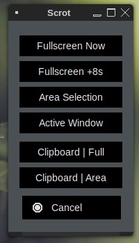

A similar yad screenshot script was developed by @sleekmason for his wonderful (but now inactive) 'Lilidog' distro.
This one lets you shoot fullscreen | fullscreen+delay | active window | select area, which are all saved to disk -- as well as fullscreen & area shots that are copied to  clipboard only.  The yad window is closed right before the actual scrot command is executed and a notification message is opened.
I made minor changes to this 'scrot-options' scipt, in such a way that a 'saved-to-disk' scrot is opened in my default image-viewer instead.  A notification is only applied for copied-to-clipboard scrots.
Maybe you could find parts of this script useful for your above project.

if ! [[ $(command -v scrot) ]]; then
notify-send --urgency low "Install 'scrot' to use this keybind"
yad --title "Scrot" --class "scrot-options" --escape-ok \
	--width=180 --height=270 --borders=15 --center --on-top \
	--button="gtk-cancel":0 --window-icon=video-display --text-align=center \
    --form --columns=1 \
    --field="":LBL "" \
    --field="Fullscreen Now:FBTN" 'bash -c "NOW & kill $YAD_PID"' \
    --field="Fullscreen +8s:FBTN" 'bash -c "LATER & kill $YAD_PID"' \
    --field="Area Selection:FBTN" 'bash -c "CAPTURE & kill $YAD_PID"' \
    --field="Active Window:FBTN" 'bash -c "WINDOW & kill $YAD_PID"' \
    --field="":LBL "" \
    --field="Clipboard | Full:FBTN" 'bash -c "COPY & kill $YAD_PID"' \
    --field="Clipboard | Area:FBTN" 'bash -c "COPYSEL & kill $YAD_PID"' \
    --field="":LBL ""
