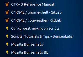

#25 2024-03-10 18:02:55
Posts: 1,071
Re: BL web favicon for dark themes
@johnraff
The favicon and BL logo at the top of the page now look good.
I checked the Crunchbang style and I think the gray logo is a good solution for the dark theme.
It usually annoys me when something breaks my css.
Today is different because I am also "guilty" of the changes.
Maybe it wouldn't be bad if the logo was refreshed every couple of years.
It is enough to change only the color.
I like the original @ututo's logo better, but the idea is the same:
