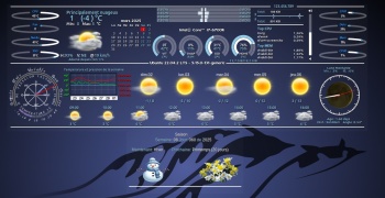

#4563 2025-03-01 07:48:58
Posts: 995
Integration of saison conky
#4564 2025-03-01 08:35:13
Posts: 2,845

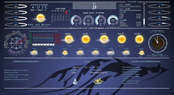

#4569 2025-03-03 09:03:09
Posts: 995
It since good , no errors since a few days .
Extract in your $HOME .
It using accuweather_conky_script with marens_french_translation .

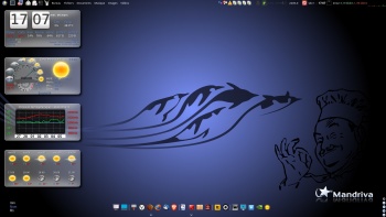

#4570 2025-03-04 16:44:43
Posts: 995
A very very old conky (Shamen in 2011]migrated in 2020 years
