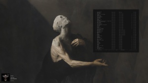

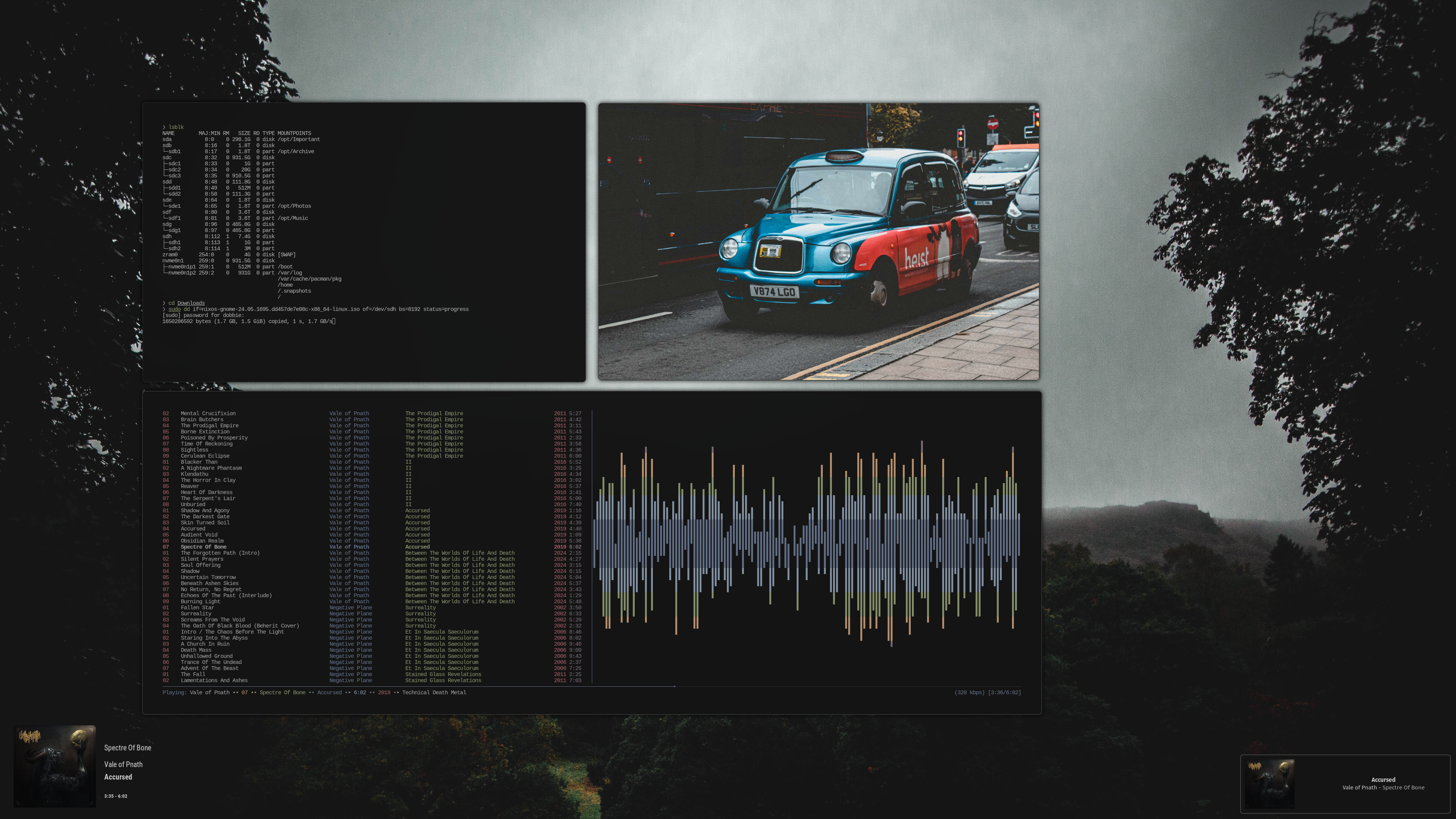

@Doobie03 That's ultra minimal and looks so cool. I'll never learn the skills to do something like that.
Thanks. You are already on the right path, I'm sure you will get there.

Back on topic -
I'm not completely sure about this terminal colour scheme.
Very monochromatic. Compare to...
https://images2.imgbox.com/70/2b/PKEfSy7S_o.png
I'm messing with sfwbar. BunsenLabs is going to be ready for the switch to Wayland when the time comes...
