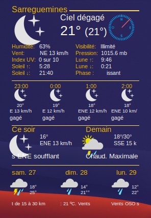

^It works here too. Only the adaptations in German still have to be made.   big_smile

Théo great job , work in french at me too.

@Teo: the script is great, no abnormalities whatsoever afaik.
finding the correct line numbers in the respective now/daily/hourly output files is a pita though... wink

the weather.com website displays 24H-formatted hours as 4-digit value --> so the nightly hours are shown with a leading zero (05.00).
but only 3-digit value is printed to the 'hourly' file. can the script also output the leading zero for these early hours?

@ceeslans
Yeah, it bothers me as well, so...
# Put the command that launches the conky configuration file that uses this script here #
weather_conky_launch_command="conky -b"

${color1}${font monofur:size=12}WETTER ${color2}${hr 2}${color}${texeci 500 bash $HOME/Weather_com_conky_script/weather_com}
${image $HOME/Weather_com_conky_script/Forecast_Images/now.png -p 0,90 -s 40x40}\
${font monofur:size=10}${color1}${texeci 600 sed -n '1p' $HOME/Weather_com_conky_script/10days} ${color}${texeci 600 sed -n '1p' $HOME/Weather_com_conky_script/now}°C(${texeci 600 sed -n '3p' $HOME/Weather_com_conky_script/now}°C)
${font}${texeci 600 sed -n '4p' $HOME/Weather_com_conky_script/10days}${alignr}${texeci 600 sed -n '1p' $HOME/Weather_com_conky_script/aktualisiert}
${goto 60}MOND${color}${alignr} ${texeci 600 sed -n '17p' $HOME/Weather_com_conky_script/now}
${goto 60}${color1}${font}Hoch / Tief${color}${alignr} ${texeci 600 sed -n '4p' $HOME/Weather_com_conky_script/now}° / ${texeci 600 sed -n '5p' $HOME/Weather_com_conky_script/now}°
${goto 60}${color1}WIND${color}${alignr} ${texeci 600 sed -n '7p' $HOME/Weather_com_conky_script/now}
${goto 60}${color1}UV INDEX${color}${alignr} ${texeci 600 sed -n '6p' $HOME/Weather_com_conky_script/now}
${goto 60}${color1}Sonnenaufgang${color}${alignr} ${texeci 600 sed -n '13p' $HOME/Weather_com_conky_script/now}
${goto 60}${color1}Sonnenuntergang${color}${alignr} ${texeci 600 sed -n '15p' $HOME/Weather_com_conky_script/now}
${goto 60}${color1}Luftdruck${color}${alignr} ${texeci 600 sed -n '10p' $HOME/Weather_com_conky_script/now}
${goto 60}${color1}Mondaufgang${color}${alignr} ${texeci 600 sed -n '19p' $HOME/Weather_com_conky_script/now}
${goto 60}${color1}Monduntergang${color}${alignr} ${texeci 600 sed -n '21p' $HOME/Weather_com_conky_script/now}
${goto 60}${color1}Fernsicht${color}${alignr} ${texeci 600 sed -n '11p' $HOME/Weather_com_conky_script/now}
${goto 60}${color1}Rel.Luftfeuchte${color}${alignr} ${texeci 600 sed -n '8p' $HOME/Weather_com_conky_script/now}
${goto 60}${color1}Taupunkt${color}${alignr} ${texeci 600 sed -n '9p' $HOME/Weather_com_conky_script/now} °C
${color2}${hr 1}${color}
${image $HOME/1_pixel_images/cyan_1.png -p 90,202 -s 1x335}\

everything works. smile
But what I don't like at all is that this Conky is using my weak CPU
inxi -Cxxx
CPU:       Single core Intel Pentium M (-UP-) cache: 2048 KB
           flags: (sse sse2) bmips: 2790 speed/min/max: 1400/600/1400 MHz
permanently loaded with ~20% and, if the images are converted, the load is 100%.  mad
Apparently I have tomatoes on my eyes, because I haven't seen the mistake for two days.   hmm
There's an old saying: "Things are better at home".   8)

ANNOUNCEMENT
Weather.com's changed their layout. Script's rewritten almost from scratch. I've also added some 1920x1080 conf files. Thanks to everyone who's helped with their feedback and support.

^Thanks, Teo.
Works perfectly!  wink
#3520 2020-06-25 20:23:00
Posts: 1,075
work great since a week
