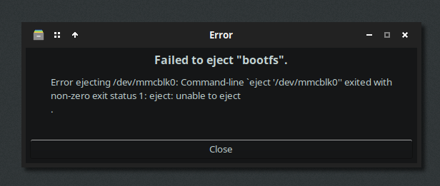

I am no longer able to unmount SD cards from my device's integrated SD card reader using Thunar.
I have tested this on a multitude of cards, both single- and multi-partition, all with the same result.
Ironically, when the SD card is unmounted I choose the option to 'Safely Remove', after receiving the error, this automatically mounts the SD card once again.
Safely remove an unmounted SD card
error
After receiving the eject error, journalctl -xe shows the mounting, unmounting:

I ran umount with the verbose tag on both partitions of the SD card.  Nothing bad reported.
I ran thunar from a terminal, and when I safely removed the partition from the Thunar window, I got the eject error again, but nothing was reported in the terminal:

Just to clarify, it's not an SSD (solid-state drive) that I'm trying to eject, but an SD (SecureDigital) card.
The laptop has an integrated SD card reader.
The eject error reported above is from both using the eject icon on the SD card (or one of its partitions) icons in the sidebar of Thunar, and/or selecting 'Safely Remove' from the right-click context menu on the same icon.  Same result.
The bootfs and rootfs partitions just happens to be the 2 partitions that comprise a raspberry pi OS distro imaged to the SD card.  I've tested this on other SD cards that are single partitions also, and with different filesystems (e.g. FAT32, EXT4...) but all with the same result.
Unmounting the SD card does the intended job, but attempting to eject results in an error then subsequently and automatically re-mounts the SD card.

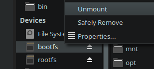

Which would correctly correspond with being able to successfully unmount the partitions in Thunar (not run as root):
I think the SD card with two partitions used above is making the issue more complicated than it needs to be.

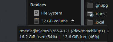

For the sake of simplicity, I mentioned that I tried this on a 32GB SD card that has a single partition:
Here is the mounted partition:
drwxr-xr-x   5 jimjamz jimjamz 32768 Jan  1  1970 8765-4321
and the full SD card as reported by fdisk:
Device         Boot Start      End  Sectors  Size Id Type
/dev/mmcblk0p1 *     8192 62333951 62325760 29.7G  b W95 FAT32

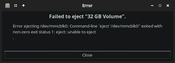

I can unmount without sudo via the terminal, and I can unmount from the right-click context menu in Thunar.
However, when I choose 'Safely remove' from the same context menu, the eject error continues to persist:
I don't think this is an issue with permissions on the mounted directory or with unmounting, but rather ejecting / safely removing from anything that is on /dev/mmc*.  USB drives / disks do not have this issue.
