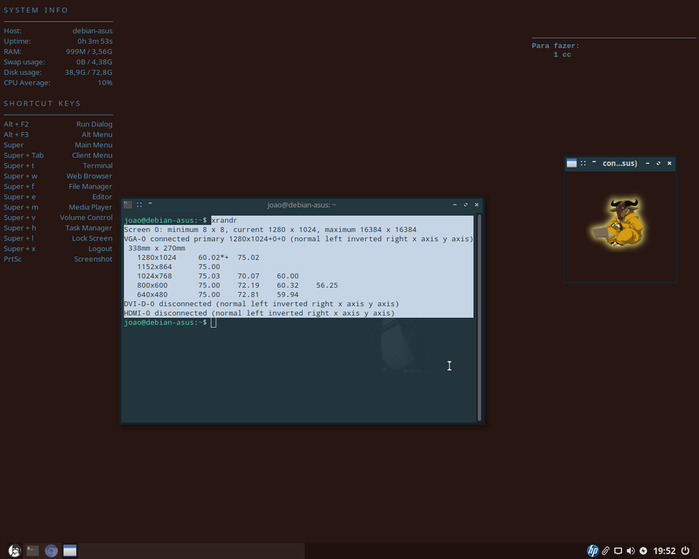

I did the output of xrandr with the new cable in use on monitor, so this options are for the resolutions that this cable can accept.
I inspect the old cable I think that is a problem with the internal cables because if I move the cable to a certain position the image haven't any flickering color.
I dont inspect autostart resolution, in fact I have other problem with this new cable, each time that I do a power on on the pc the monitor always start in 1280x720 with a big openbox menus etc ... , I always need open → menu → arandr and then change the resolution for 1152x864,  and the conkys and wallpaper isn't centered on the monitor.

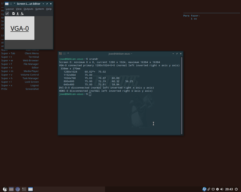

But all VGA-cables just transfers the signals from your graphic card to the monitor. There should not be any difference in resolution with different VGA-cables. If you attach the old FGA-cable, you will se that the output of xrandr is the same, regardless what VGA-cable you have attached. Check it out...
But you are supposed to tell the computer what screen resolution you want to have, if it don't can find one for you suitable.
You do that in the autostart. Easiest way:
When you in ARandR, have set prefered screenresolution, save it. Klick menu "Layout" =>  Save As. Save it as ~/.screenlayout/screen.sh.
Open your ~/.config/bunsen/autostart.
Search, if you have any note of screen resolution. Else add a call to ~/.screenlayout/screen.sh, quite high up in autostart.

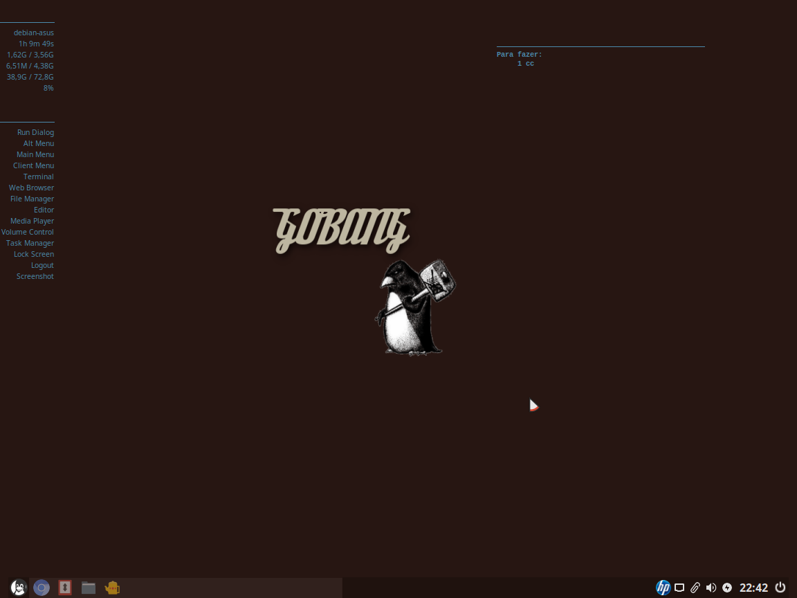

I do a screenshot of my desktop with this problematic cable →

I buy a new cable today and the problem is the same, so at this time I already test 2 new cables and both dont work.
I change the cable to the older cable and reboot and the monitor starts work on 1280x1024 as you can see on image →
Old cable xrandr output →
joao@debian-asus:~$ xrandr
Screen 0: minimum 8 x 8, current 1280 x 1024, maximum 16384 x 16384
VGA-0 connected primary 1280x1024+0+0 (normal left inverted right x axis y axis) 338mm x 270mm
   1280x1024     60.02*+  75.02
   1152x864      75.00
   1024x768      75.03    70.07    60.00
   800x600       75.00    72.19    60.32    56.25
   640x480       75.00    72.81    59.94
DVI-D-0 disconnected (normal left inverted right x axis y axis)
HDMI-0 disconnected (normal left inverted right x axis y axis)

In the picture you can see the resolution at this momment I work with the old cable.
So the problem is the cables I think but I unknown Why this dont work.
Maybe if I reinstall nvidia drivers or change the distribution works.
