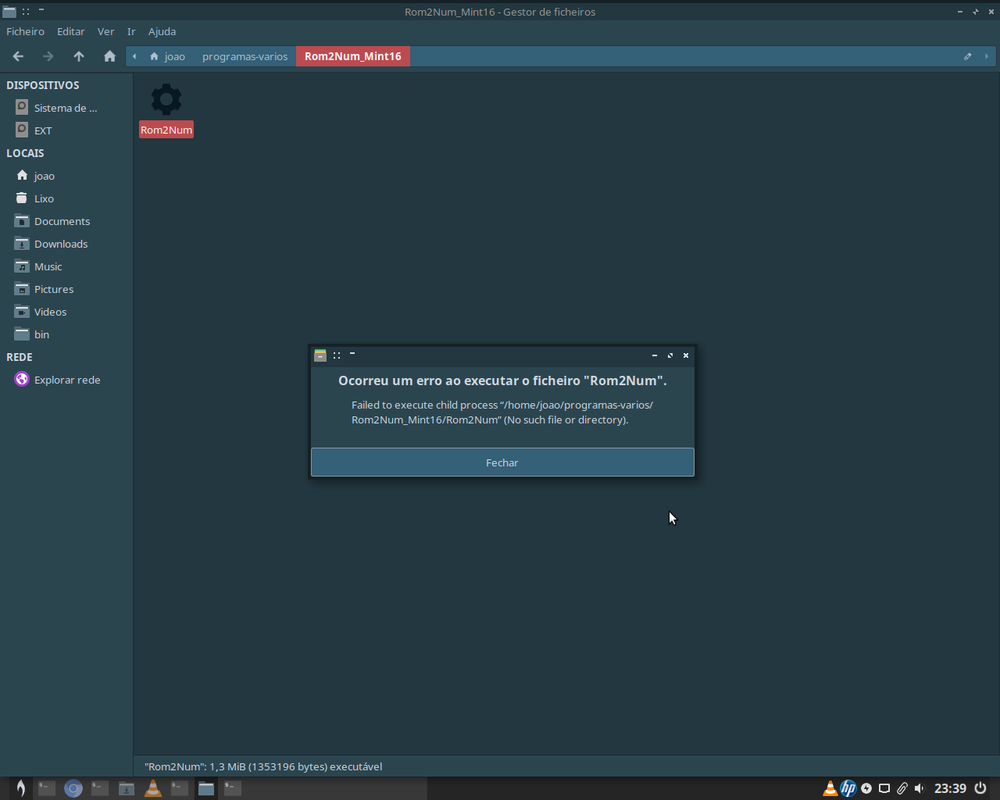

Now I try to use one simple program that I down from web years ago in my Ubuntu he works well but now in Bunsenlabs I cant find the way to make this work, is a simple executable, isn't a .deb package.
I search on web for the website where I down the package and I cant find it, but I have the .tar.gz file so I upload here to find if any can give me the way to install (run) it →https://easyupload.io/fc68c5
I also take a screenshot fo the problem when I try to execute the file →
If anyone know some program that do the same work please put here the info, the program does conversions between roman and arabic numbers or arabic and roman numbers.
Thanks

Welcome to the BunsenLabs forum.  This question sounds like it's not particularly related to BunsenLabs, even though that's the operating system you're now using.
The "No such file or directory" part of the error message you posted suggests that your script has a missing dependency, like there was some software on your computer previously that's not on it now and that software is required for this script to work... and if that's the kind of trouble you're having then you'll want to learn more about how scripts work (a general issue unrelated to BunsenLabs).
If you're wondering "how to do conversions between roman and arabic numbers" searching the internet for that exact/similar phrase would probably yield better results than this forum.
Good luck!

That executable doesn't run on my system either. If you just want a "Roman to Number" converter then search on github - there are lots to choose from here: https://github.com/search?q=roman+to+number&type=
