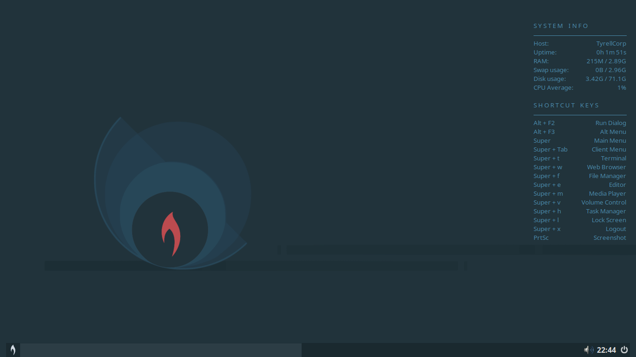

I did a little test. Pulse was already removed, but default login RAM after that was about 380 for me, and over 400 after opening any GUI, even jgmenu.
sudo apt purge --autoremove clipit xfce4-power-manager openssh-agent at-spi2*
I think that's right. Then, since ceni is now in debian...
sudo apt install ceni && sudo apt purge --autoremove network-manager-gnome lightdm* light-locker
I switched to Adwaita icon theme. Reboot for the win. 215 running xfce4-screenshooter...
-edit- I checked, removing pulseaudio seems to make no difference on RAM usage. Desktop idle after opening and closing both Firefox and also Thunar (which enables gvfs and tumblerd) was under 245mb. I say that's very good for what is still a pretty complete desktop.
