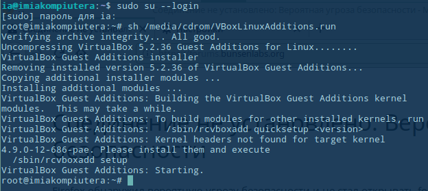

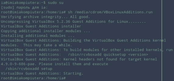

The installer says it can not find kernel headers. If you had done the search, you would have found:
# apt install build-essential linux-headers-$(uname -r)
After that, run the installer again.

Image 1
image 2
iMBeCil, Sorry, did not see your link.

According to your screendump, the system says that virtual box guest additions started.
So, does services like Shared clipboard and shared folders now work for you?
Maybe you shold edit the subject line to: "Install virtual box guest additions"?
