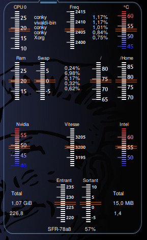

While we're on the subject of @Olgmen....  I also tinker.  wink
https://i.imgur.com/gt9cncat.png
I like it.  Can you share the LUA scripts for the bottom one?
Ich mag das. Können Sie die LUA-Skripte für das unterste teilen?
Of course, my friend, I have for you the complete package of this friendly Russian, what he provided to users at that time on ubuntu.ru. Because, this also requires colorizecore (you will know it).  wink
https://workupload.com/file/8KCnpnBKHeY

Posts: 8,400
OH MY!!!  Now that's a blast from the past.
Got it ... tomorrow - RL permitting I'll play.
RL  = Real Life

I need your help Olgmen says this :
У скрипта есть небольшая особенность, нет ограничения по параметру max, что очень подходит для вывода значений работы интернета. Вид изображения, горизонтальная или вертикальная шкала, выбирает сама программа. Если высота шкалы больше ширины, то выводится вертикальная шкала, если ширина больше высоты - горизонтальная. Мой скрипт можно взять здесь.
The script has a small feature, there is no limit on the max parameter, which is very suitable for displaying the values of the Internet. The type of image, horizontal or vertical scale, is chosen by the program itself. If the height of the scale is greater than the width, then a vertical scale is displayed; if the width is greater than the height, a horizontal scale is displayed.
To made this , but by me since a fews years that don't work.
If anyone have any idea.
{                 -- горизонтальная шкала, цифры сверху horizontal scale, numbers on top
 name = "time",
 arg = "%S",
 x = 50,
 y = 250,
 width = 120,
 height = 50,
 scale = 20,
 font = "Ubuntu",
 font_size = 12,
 side = "left",
 colour_scale = {{0, 0xff0000, 1},{0.5, 0xffffff, 1},{1, 0x0000ff, 1}},
Many tanks
#1889 2023-04-22 01:43:37
Posts: 8,400
{snip}
That looks so familiar ...
I'll look around.

#1891 2023-04-22 14:30:04
Posts: 1,075
@ Scector11
Tank you for looking.
If may i allow :side does not work either
#1892 2023-04-22 21:20:14
Posts: 8,400
@ Scector11
I'm getting close... I think the originals were by mrpeachy - unless mrpeachy got them from olgmen.
But I think mrpeachy would have given credit where credit is due.
I have a whole bunch of LUA scripts in one test conky:
00_crono_test.conky
when I do a
find .lua
in the conky I get 76 occurances, mrpeachy, easysid, Didier-T, mclovin, DrakarNoir and a whole bunch that were/are bent, folded and mutilated by me.
