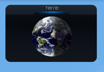

#1830 2023-03-26 15:57:51
Posts: 1,075
earth full disk  image tired from this
donne this

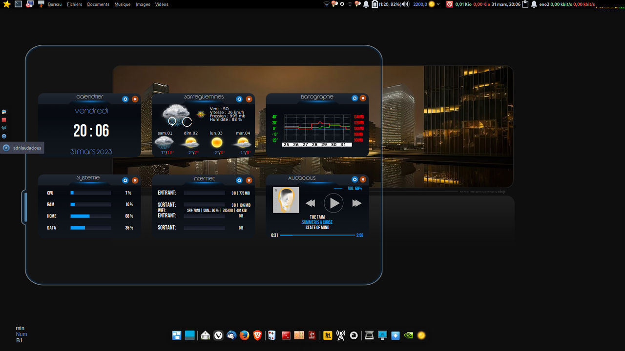

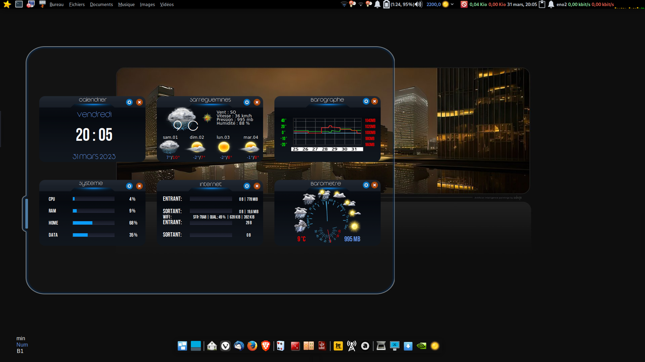

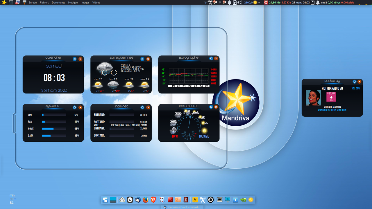

Posts: 1,075
Hello guys
I miss the old version of conky which allowed the click on it.
Now I have to put shortcuts in a dashboard, it works too but it's less fun.
I still managed to make something decent.
Here the normals conkys
slideshow conky
radiotrayng conky
audacious conky
Here with the three conky's in overlay
