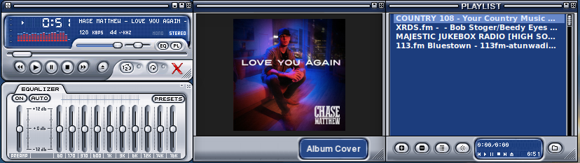

This is my Audacious-stream-conky (in the middle):
Chase Matthew  -  Love You Again

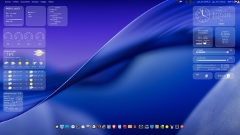

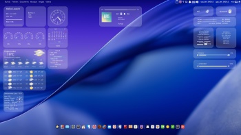

#2411 2025-09-13 14:30:25
Posts: 1,053
Right conkis start on login
Each conky on the left, as well as audacious and radiotray_NG in the middle, have their own launcher ( start & kill) that allows me to choose what i want to see on the desktop.

#2420 2025-09-18 09:52:48
Posts: 2,956
To clarify one again:  big_smile
Starting with conky -v 1.22.2, not only is a correctly created configuration of the syntax (with ‘vim’) expected, but the storage location of the configuration is also absolute.
$HOME/.config/conky/path/myConky
Personally, I have never worked with Vim. Nor will I. However, I have experienced under Wayland that the conversion of the old syntax from 1.9 with the convert.lua tool is not accepted. I cannot say what was so ‘special’ about this code.
The following image illustrates the ‘problems’ with Wayland:  eMNQUApt.png
The Conky at the top only appears with
out_to_wayland = true,
and the Conky at the bottom only with
--out_to_wayland = true,
In addition, there is a bug in Conky with the “absolute” path:
lua_load = ‘~/.config/conky/your_script.lua’,
or
lua_load = ‘$HOME/.config/conky/your_script.lua’,
It had to be:
lua_load = os.getenv(“HOME”) .. ‘/.conky/lua/image.lua’,
Source
