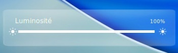

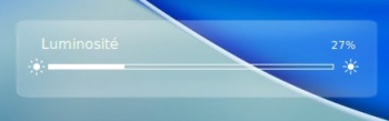

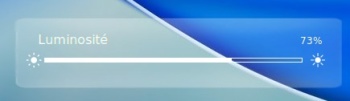

#2323 2025-07-16 18:41:11
Posts: 1,052
Good evening,
Thanks guys for your help, it works very well but I had to modify it a little.
The actual_brightness file is created correctly but I couldn't figure out how to write the result in the execbar.
So modify your script marens.
## max_brightness = 24000
current=$(cat /sys/class/backlight/*/actual_brightness)
percentage=$(echo "scale=1;$current/240 + 0.5" | bc | awk '{print int($1)}')
echo $percentage > $HOME/actual_brightness
with this
echo $percentage
echo $percentage > ~/.conky/Tahoe/actual_brightness
in conky made this for the bar
${voffset 10}
${goto 32}${font :size=12}Luminosité ${font} ${alignr 20}${exec sed -n '1p' ~/.conky/Tahoe/actual_brightness}%
${voffset -5}
${goto 40}${execbar 5,320 exec ~/.conky/Tahoe/scripts/luminosite.sh}
This gives the following with several percentages:
Vielen Dank für eure Hilfe, es funktioniert sehr gut, aber ich musste es ein wenig anpassen.
Die Datei „actual_brightness” wird korrekt erstellt, aber ich habe nicht herausgefunden, wie ich das Ergebnis in die Execbar schreiben kann.
Also passe dein Skript an, marens.
#2324 2025-07-16 20:34:30
Posts: 1,199
löotch wrote:
with this:
echo $percentage
You can delete the line:
echo $percentage
The line echo $percentage  can be used if you want to check (as a control) the percentage when you run a script in the terminal.
The path has been changed to ~/.conky/Tahoe/actual_brightness  as I said above and that's OK.
Anyway, the script works as expected.
I couldn't test it, but the assumption was good.
The screenshots look fine.
Try setting the brightness to 12000 and see if you get 50%.

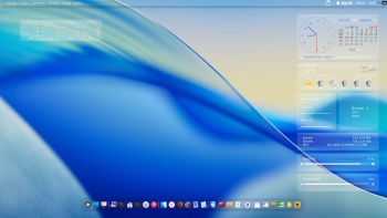

#2329 2025-07-17 15:26:16
Posts: 2,954
This should work in your case (if max_brightness = 15):
## max_brightness = 15
percentage=$(echo "scale=1;$current*100/15 + 0.5" | bc | awk '{print int($1)}')
echo $percentage
echo $percentage > $HOME/actual_brightness-percent
Of course it works! With your scripting skills, there's no question about it!  wink
Thank you for that and I've saved it to my Conky archive (I don't really need this ad).  smile
