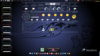

Here are a few possible choices depending on my current mood
choice 1
number 2
number 3
#2222 2025-03-12 15:42:26
Posts: 3,046
Je serais pour le numéro 3, car c'est cette création avec la montre qui me plaît le plus.  wink
Mon humble travail d'aujourd'hui.
I would go for number 3 because I like this creation with the watch the best.
My humble work from today.

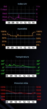

Apart from the speed of the wind gusts, I think I've understood everything. Some of the graphs are practically the same because I cheated a bit, I took the same log to have a single line. The scripts work well, no errors in the console and the log files work well because the last entries are different.
We'll see in a few days.
09NVp5SS_t.png.

#2229 2025-03-15 12:06:31
Posts: 1,285
The graphs look great, but some things don't make sense.
You need a weather forecast for next week (instead of last week).
In practice, this means from March 15th to March 21nd.
I think the problem is in the script here:
DATE=$(date +"%s")
DATE1WEEK=$(date --date="1 week ago" +"%s")
https://forums.bunsenlabs.org/viewtopic … 11#p136911
Try:
DATE1WEEK=$(date --date='+1 week' +'%s')
I don't have the API and can't test it, but I don't believe AccuWeather provides data for the past seven days.
Also, the log you provided here (listePression.log) is for the next 24 hours, not the entire week:
https://forums.bunsenlabs.org/viewtopic … 52#p136952
Anyway, progress has been made and I'm glad they stopped using @TBG's Accuweather_conky_script on another forum.
They didn't understand how the script even worked, nor did my hourly forecast plugin.
Good luck.

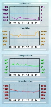

#2230 2025-03-17 21:41:58
Posts: 1,070
In fact for the graph I use curr_cond from accuweather which gives me an entry every hour which gives me an average for the past week.
Now for a test I would like to modify it for a daily graph it works I have a graph .
This afternoon
Now
You can see that the 17th is moving to the left, which is today's date, and I think that at midnight the 18th will appear.
I've fiddled around but can't figure out how to display the hours instead of the day.
DATE=$(date +"%s")
DATE1WEEK=$(date --date="1 day ago" +"%s")
i try this & many others thinks but they don't work
DATE=$(date --date="1 hour ago" +"%s")
here full code

#2231 2025-03-18 00:29:40
Posts: 1,285
Unfortunately, I can't test it because I don't have all the dependencies installed and I don't know what the LOG files look like, but I would try something like the temperature for the next seven days (one week) this way:
DATE=$(date --date='+1 week' +'%s')
DATE1WEEK=$(date +'%s')
Explanation:
In days it would look like this:
$ date --date='+1 week'
Tue 25 Mar 2025 01:01:11 AM CET
$ date
Tue 18 Mar 2025 01:01:35 AM CET
Or in seconds (as the script requests):
$ date --date='+1 week' +'%s'
1742861232
$ date +'%s'
1742256465
If the LOG is correct, you should get a graph for the next 7 days.
From  March 18  to  March 25.
#2232 2025-03-18 08:26:17
Posts: 1,070
The date change worked, but where am I going to find the temperatures & pressure  for next week?
I can use this for temperature
TEMP=`sed -n '4p' $HOME/Accuweather_conky_script/daily_forecast`
