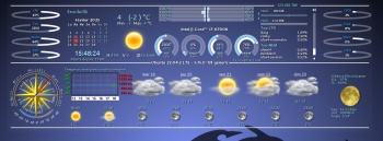

#2213 2025-02-13 09:06:03
Posts: 1,088
Here the lastest, i think i have it
#2214 2025-02-13 09:38:45
Posts: 3,183
https://thumbs2.imgbox.com/ab/c7/X2mibzxE_t.png
Exactly!
That's phenomenal! wink

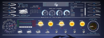

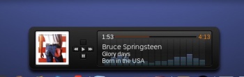

#2216 2025-02-15 14:59:25
Posts: 1,088
Danke .
I have it .
Not like on mageia 5 with conky 1.9 but here there are two of them .
radiotrayng in 2016 with impulse
today in 2025
audacious in 2016
today

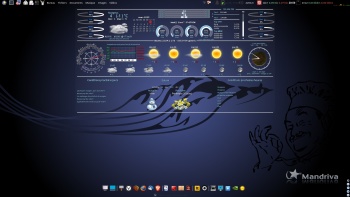

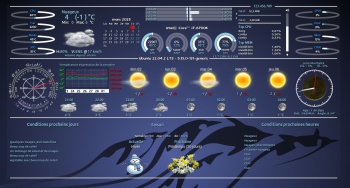

#2219 2025-03-01 19:55:35
Posts: 1,088
All conkys can be launched separatly
Principal conky 1x
with left & right 3x
With weather conky barograph & barometer 4x
with season & extra 5x
& screenshot
If you wan scripts , you must wait a few more days as I have some bugs in the console.
