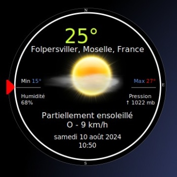

#2122 2024-08-10 08:51:56
Posts: 957
Back from hospital again nothing great just a little conky circle with accuweather_conky_script the coding helps me forget my headache for a bit .

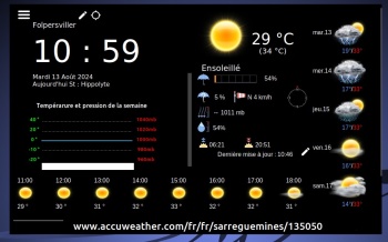

#2133 2024-08-13 09:11:51
Posts: 957
Hello guys
Tanks for hekping .
listePression.log
1723455237 13 28
1723455283 13 28
1723455397 13 28
1723455443 13 30
1723455534 13 33
1723456379 13 33
1723456466 13 33
1723456547 13 33
1723458380 13 33
1723458408 13 36
1723458417 13 36
1723462520 13 36
1723462586 12 36
1723463797 12 36
1723464312 12 36
1723464367 12 36
1723464407 12 36
1723464443 12 36
1723464768 12 36
1723464831 12 36
1723464888 12 36
1723476784 12 36
1723477086 12 36
1723478559 11 36
1723478760 11 36
1723479202 11 36
1723480402 11 36
1723481618 11 33
1723482818 11 33
1723483894 11 33
1723483911 11 33
1723484024 11 33
1723485240 10 33
1723486174 10 33
1723486445 10 33
1723487646 10 33
1723488863 10 33
1723490063 10 33
1723491264 10 33
1723492480 10 27
1723493681 10 27
1723538777 9 27
1723538832 10 34
1723538852 10 34
1723538903 10 34
1723539549 11 34
1723539641 11 34
normal script
with
date --date="1 day ago" +"%S"
with
date --date="1 day ago" +"%H:%M"

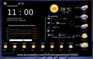

#2134 2024-08-13 09:29:48
Bearded_Blunder
Dodging A Bullet
From: Seat: seat0; vc7
Posts: 1,146
If that's the complete log, there is only about 24 hours data in there (~23hrs 26min), I'm not entirely certain what the issue is...
The one you say is "normal script" looks about what you'd expect for it appearing on a graph that covers a week, the second looks about what you'd expect for a graph covering 1 day..
The graphs even look the same allowing for the stretched time axis in the second screen grab.
What problem are you seeing that I'm not?
I'm sure I'm missing something...
#2135 2024-08-13 09:38:34
Posts: 957
Oki-doki
I'm going to delete my .log, modify the script and leave it running. We'll see if anything changes in a few hours.
thanks again
