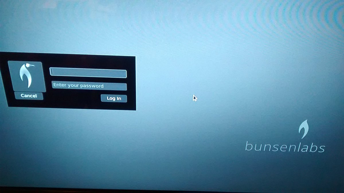

Another try with ODROID-U3 .... and full working except the network.
Debian Jessie minimal http://forum.odroid.com/viewtopic.php?f=79&t=17770
