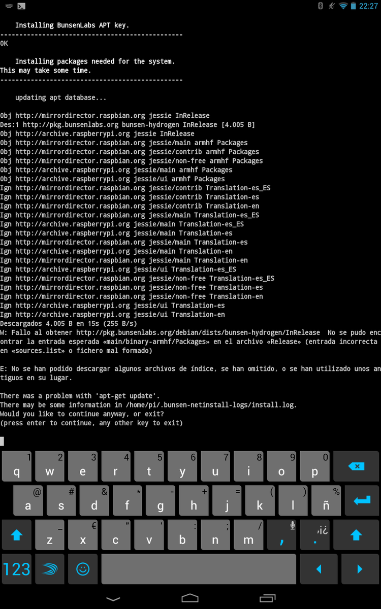

I can't install on Raspberry Pi over Raspbian Jessie lite. I receive this message...
Failed to obtain /main/binary-armfh/ from BunsenLabs
What a shame!

Just a note, this would have to be based on the netinstall. live-build in jessie only supports i686/586 and amd64.

If the former, it is somewhat platform-agnostic, but as manuti found, there seems to be an issue with the Bunsen package repo when installing on arm. The installed packages themselves are all 'Architecture all', but there are a couple in the 'bunsen-hydrogen' repo which are only amd64 or i386. That might be the problem?

^ Could be; I'd forgotten we have a couple packages that you guys had to backport because they aren't available in Jessie (or the package in Jessie has problems, like xfce4-power-manager) and we couldn't find acceptable substitutes.

I find this interesting and today cross-compiled a few packages for armhf (=ARMv7 with VFPv3) -- it just werks(TM), the extra work is basically NIL; just an additional pbuilder command. The only drawback is that compilation of anything ARM is very SLOW due to emulation (only binary packages need to be specificially rebuilt for ARM, but still).
So I've created a armhf distro on the repository which contains all architecture-independent BL packages plus yad (upcoming dependency). Funnily, building my own forecast(1) program fails due to troubles with ncursesw5 but I had planned to move it into jessie-backports anyway, so no harm. I've also built compton & dfc in the jessie-backports repo for armhf, meaning that BL could be added to a ARM-based Debian system just via apt (most parts) Could somebody test if the binary packages work (I don't own any ARM platform (Android phones do not count))? If all works well, I could add the arm64 and armel archs too as well as the rest of the packages for armhf (if there's no trouble waiting to be discovered).
