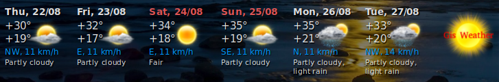

#4546 2024-08-21 14:44:20
Posts: 1,197
Gis Weather
The author fixed the application on May 31.
https://forums.bunsenlabs.org/viewtopic … 47#p135047
Now it doesn't show the forecast for the next few days at all.
Again there were changes in the source (gismeteo).
Of course, at this point I don't know if the changes are only temporary.
Those using my settings (and others) can fix now:
Open ~/Downloads/gis-weather-master/services/gismeteo.py  file.
This part now looks like this:
    # day of week, date
    day = re.findall('<day.*? date="(.*?)"', source)
    day.pop(0)
    for i in range(len(day)):
        dt1 = datetime.strptime(day[i], '%Y-%m-%d')
        day[i] = dt1.strftime('%a')
    date = re.findall('<day.*? date=".*?-(.*?)"', source)
    date.pop(0)
    for i in range(len(date)):
        s = date[i].split('-')
        date[i] = s[1]+'.'+s[0]
Restart Gis Weather.

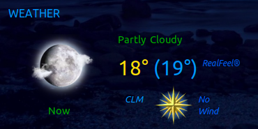

#### Marens hourly
Finally it happened that there is no wind here.
Accuweather conky and Gis Weather give the same result:
I went to accuweather.com  and saw the weather forecast (wind) for the next hour:
Then I ran the script once in the terminal:
$ bash $HOME/Accuweather_conky_script/accuweather -h2015
I don't have any conky with an hourly  forecast, but I got a confirmation in the file manager:
The CLM wind rose appeared as wind_1.png.

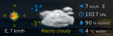

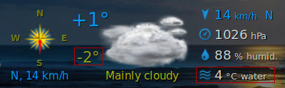

As you know, Gis Weather shows the dew point  (water) at the end of the info block.
I thought it would be better if I replaced it with Ⓡfeel  temperature.
I looked at the source  some more and I think (not sure yet) that I found the right value.
If anyone wants, they can test with me.
It's very easy.
Open ~/Downloads/gis-weather-master/services/gismeteo.py  file and find:
    # water temperature now
    t_water_now = re.findall('<fact.*? water_t="(.*?)"', source)
    t_water_now = t_water_now[0]+';'+str(int(C_to_F(t_water_now[0])))+';'+C_to_K(t_water_now[0])
Replace with:
    #t_water_now = re.findall('<fact.*? water_t="(.*?)"', source)
    #t_water_now = t_water_now[0]+';'+str(int(C_to_F(t_water_now[0])))+';'+C_to_K(t_water_now[0])
    # temperature Ⓡfeel now - Marens Settings
    t_water_now = re.findall('<fact.*? hi="(.*?)"', source)
Then open the ~/Downloads/gis-weather-master/gis-weather.py  file and find:
                    self.draw_text(cr, t_water_now.split(';')[t_scale]+"<span size='x-small'> %s %s</span>"%(t_scale_dict[t_scale], _("water")), x0+20, y0+line_height*3-1, font+' Normal', 12, 100,Pango.Alignment.LEFT)
Replace with:
                    #self.draw_text(cr, t_water_now.split(';')[t_scale]+"<span size='x-small'> %s %s</span>"%(t_scale_dict[t_scale], _("water")), x0+20, y0+line_height*3-1, font+' Normal', 12, 100,Pango.Alignment.LEFT)
                    self.draw_text(cr, t_water_now.split(';')[t_scale].replace('-0', '0')+"<span size='x-small'> %s %s</span>"%(t_scale_dict[t_scale], _("Ⓡfeel")), x0+20, y0+line_height*3-1, font+' Normal', 12, 100,Pango.Alignment.LEFT)
Fixed  " -0 "  output for Ⓡfeel in gis-weather.py.
The code has changed.
Before:                            After:

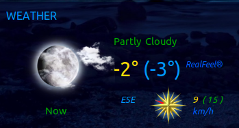

#4559 2025-01-14 00:25:20
Posts: 1,197
Gis Weather
So far everything looks good.
This was wrong.
I think it's not about the dew point, but the water temperature (river, lake, sea...) in current conditions.
So I decided to leave it and add a temperature Ⓡfeel below the current one (inside Block Now).
I changed the code and got this:
Testing continues.
Several times a day I compare the results with  accuweather  and  my conky  (local source):
https://forums.bunsenlabs.org/viewtopic … 30#p134630
If anyone is interested, I will post the new code.

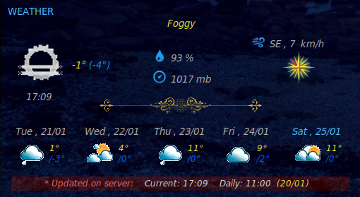

#4560 2025-01-20 17:22:39
Posts: 1,197
^ I think the testing is over.
Gis Weather  data was updated on server 2 hours ago.
Accuweather  and  my weather conky  (local source) provide fresher data.
The latter is the most accurate because the automated weather station is located in a nearby city park a few hundred meters from me.
