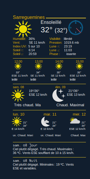

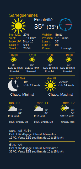

No, it's not good. The icons for 10 days changed their numbering. For the day are used: d2, d4, d6. In turn, d1, d3, d5 ... are for the night.
Presumably, after switching to day mode, the opposite is true. Otherwise, you have a moon every other day. Additionally, for 10 days it is worth changing "for ((i = 1; i <= 15; i + = 1))" to "for ((i = 1; i <= 20; i + = 1))" in the script, because without of this, icons are only downloaded for 7 consecutive days.

I've noticed it as well guys.
The problem exists only with the non english versions of the scripts (German, French, Greek, etc.).
I'll see what I can do.

Added one more variable to the script - night=Night
Change according to your language, ie. Nacht, Nuit, Νύχτα, etc.

^^Teo, you tireless weather worker, thanks for the script.
Now the change between day and night has occurred and the display is brilliant between the two.  big_smile
I really hope it lasts long!  wink
