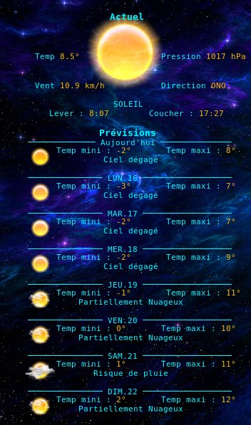

OK back to the weather... I revamped a conky between yesterday, today and other things "life"  Something about the "firs mono" font Teo turned me onto that I LOVE:  I can see it very clearly at smaller sizes - two years ago things were fine, then I needed 'computer glasses' - then I needed 'computer glasses' and larger fonts.  sad  and along come: Fira Mono
So I made it narrower and just a little shorter, because the images are a little bigger.
You need: fira mon font, 1_accuweather and 4_moon.
SEMqU5hR.jpg old on the left new on the right.
S11-Clock-9day-Moon-16.conky
# pkill -xf "conky -q -c ~/1_accuweather/S11-Clock-9day-Moon-16.conky" &
# Created: Wed 26 Oct 2016 14:21:13
## ---------- Begin Window Settings
own_window yes
own_window_type normal
own_window_transparent yes
own_window_hints skip_taskbar,skip_pager,undecorated,below #,sticky
own_window_colour 000000
own_window_class Conky
own_window_title A Clock - Weather & Moon 2016
# ARGB can be used for real transparency
#  own_window_argb_visual yes ## Options: yes or no
# Valid range is 0-255, where 0 is 0% opacity, and 255 is 100% opacity.
#  own_window_argb_value 70
minimum_size 180 900
maximum_width 180
gap_x 10	## l|r
gap_y 10	## u|d
alignment tl
## ---------- End Window Settings
## ---------- Font Settings
## Use Xft (anti-aliased font and stuff)
use_xft yes
#xftfont Fantasque Sans Mono:bold:size=11
xftfont Fira Mono:bold:size=8
## Alpha of Xft font. Must be a value at or between 1 and 0
xftalpha 1.0
## Force UTF8? requires XFT
override_utf8_locale yes
## --------- End Font Settings
## --------- Color Settings
draw_shades yes
default_shade_color 000000
draw_outline no
default_outline_color 000000
default_color f5fffa ## MintCream
color1 778899 ## LightSlateGray
color2 FFA07A ## LightSalmon
color3 87CEFA ## LightSkyBlue
color4 48D1CC ## MediumTurquoise
color5 FFDEAD ## NavajoWhite
color6 00BFFF ## DeepSkyBlue
color7 B0E0E6 ## PowderBlue
color8 FFD700 ## Gold
color9 CD5C5C ## IndianRed
## ---------- End Color Settings
## ---------- Begin Borders Section
draw_borders no
## Stippled borders?
stippled_borders 5
## border margins
border_inner_margin 5
border_outer_margin 0
## border width
border_width 2
## graph borders
draw_graph_borders yes ## no
## default_graph_size 15 40
## ---------- End Borders Secton
## ---------- Begin Miscellaneous Section
## Boolean value, if true, Conky will be forked to background when started.
background yes ## yes
imlib_cache_size 0
## Adds spaces around certain objects to stop them from moving other things
## around, this only helps if you are using a mono font
## Options: right, left or none
use_spacer none
## Subtract (file slystem) buffers from used memory?
no_buffers yes
## Use the Xdbe extension? (eliminates flicker)
## It is highly reco${color}mmended to use own window with this one
## so double buffer won't be so big.
double_buffer yes
update_interval 1
#TEXT --- Remove line below TEXT when developing new conky
# These lines not required see: S12_time_tm.conky
#${execi 900 bash $HOME/1_accuweather/1_accuweather -f2015 -f2016 -h2015 -h2016}\
#${execi 900 bash /media/5/Conky/4_Moon/moon}\
${image /media/5/Conky/images/bk_10.png -p -5,-5 -s 220x1000}\
${image /media/5/Conky/4_Moon/0.png -p 5,138 -s 60x60}\
${image $HOME/1_accuweather/forecast_2016/forecast_0.png -p 25,135 -s 140x140}\
${alignc}${color5}${swapbar 0,15} Today's Sun Data ${swapbar 0,15}${color}
Rise${color7} ${execpi 600 sed -n '14p' $HOME/1_accuweather/curr_cond}\
${alignr}${color}Set ${color7}${execpi 600 sed -n '15p' $HOME/1_accuweather/curr_cond}${color}
${alignc}Duration: ${color7}${execi 300 sed -n '16p' $HOME/1_accuweather/curr_cond}
${font LED_mono:size=30}${goto 20}${color1}88:88:88${goto 20}${color5}${time %T}${color}${font}
${font Fantasque Sans Mono:bold:size=16}${color5}${alignc}${time %a %d %b %Y}${color}${font}
${alignc}${color7}${if_match ${time %H}<12}Good Morning${else}\
${if_match ${time %H}<18}Good Afternoon${else}Good Evening${endif}${endif}${color}
${font monofur:bold:size=16}${color5}±${execpi 600 sed -n '3p' $HOME/1_accuweather/curr_cond}\
${alignr}${color}${execpi 600 sed -n '2p' $HOME/1_accuweather/curr_cond}${font}
Bar ${color7}${execpi 600 sed -n '8p' $HOME/1_accuweather/curr_cond}${color}\
${alignr}Cld ${color7}${execi 90 sed -n '10p' $HOME/1_accuweather/curr_cond}${color}
UVI ${color7}${execpi 600 sed -n '9p' $HOME/1_accuweather/curr_cond} /11${color}\
${alignr}Hum ${color7}${execpi 600 sed -n '7p' $HOME/1_accuweather/curr_cond}${color}
 DP ${color7}${execi 90 sed -n '12p' $HOME/1_accuweather/curr_cond}${color}\
${alignr}Vis ${color7}${execi 90 sed -n '13p' $HOME/1_accuweather/curr_cond}${color}
${alignc}Wind ${color7}${execi 90 sed -n '5p' $HOME/1_accuweather/curr_cond}\
 ${color}@ ${color7}${execi 90 sed -n '6p' $HOME/1_accuweather/curr_cond}${color}
${alignc}${color5}${swapbar 0,15} TEN DAY FORECAST ${swapbar 0,15}${color}
${alignc}${pre_exec echo `date --date="0 day" | awk '{print $1" "$3" "$2}'`}\
       ${pre_exec echo `date --date="1 day" | awk '{print $1" "$3" "$2}'`}
${image $HOME/1_accuweather/forecast_2016/forecast_1.png -p 22,352 -s 50x50}\
${image $HOME/1_accuweather/forecast_2016/forecast_2.png -p 129,352 -s 50x50}\
${color5}${if_match "${execpi 300 sed -n '4p' /home/sector11/1_accuweather/first_days}" == "Lo"}\
${else}${execpi 300 sed -n '3p' /home/sector11/1_accuweather/first_days}${endif}\
${alignr 60}${execi 90 sed -n '8p' $HOME/1_accuweather/first_days}${color}
${color7}${if_match "${execpi 300 sed -n '4p' /home/sector11/1_accuweather/first_days}" == "Lo"}\
${execpi 300 sed -n '3p' /home/sector11/1_accuweather/first_days}\
${else}${execpi 300 sed -n '4p' /home/sector11/1_accuweather/first_days}${endif}\
${alignr 60}${execi 90 sed -n '9p' $HOME/1_accuweather/first_days}${color}
${alignc}${pre_exec echo `date --date="2 day" | awk '{print $1" "$3" "$2}'`}\
       ${pre_exec echo `date --date="3 day" | awk '{print $1" "$3" "$2}'`}
${image $HOME/1_accuweather/forecast_2016/forecast_3.png -p 22,417 -s 50x50}\
${image $HOME/1_accuweather/forecast_2016/forecast_4.png -p 129,417 -s 50x50}\
${color5}${execi 90 sed -n '13p' $HOME/1_accuweather/first_days}\
${alignr 60}${execi 90 sed -n '18p' $HOME/1_accuweather/first_days}${color}
${color7}${execi 90 sed -n '14p' $HOME/1_accuweather/first_days}\
${alignr 60}${execi 90 sed -n '19p' $HOME/1_accuweather/first_days}${color}
${alignc}${pre_exec echo `date --date="4 day" | awk '{print $1" "$3" "$2}'`}\
       ${pre_exec echo `date --date="5 day" | awk '{print $1" "$3" "$2}'`}
${image $HOME/1_accuweather/forecast_2016/forecast_5.png -p 22,482 -s 50x50}\
${image $HOME/1_accuweather/forecast_2016/forecast_6.png -p 129,482 -s 50x50}\
${color5}${execi 90 sed -n '23p' $HOME/1_accuweather/first_days}\
${alignr 60}${execi 90 sed -n '3p' $HOME/1_accuweather/last_days}${color}
${color7}${execi 90 sed -n '24p' $HOME/1_accuweather/first_days}\
${alignr 60}${execi 90 sed -n '4p' $HOME/1_accuweather/last_days}${color}
${alignc}${pre_exec echo `date --date="6 day" | awk '{print $1" "$3" "$2}'`}\
       ${pre_exec echo `date --date="7 day" | awk '{print $1" "$3" "$2}'`}
${image $HOME/1_accuweather/forecast_2016/forecast_7.png -p 22,547 -s 50x50}\
${image $HOME/1_accuweather/forecast_2016/forecast_8.png -p 129,547 -s 50x50}\
${color5}${execi 90 sed -n '8p' $HOME/1_accuweather/last_days}\
${alignr 60}${execi 90 sed -n '13p' $HOME/1_accuweather/last_days}${color}
${color7}${execi 90 sed -n '9p' $HOME/1_accuweather/last_days}\
${alignr 60}${execi 90 sed -n '14p' $HOME/1_accuweather/last_days}${color}
${alignc}${pre_exec echo `date --date="8 day" | awk '{print $1" "$3" "$2}'`}\
       ${pre_exec echo `date --date="9 day" | awk '{print $1" "$3" "$2}'`}
${image $HOME/1_accuweather/forecast_2016/forecast_9.png -p 22,611 -s 50x50}\
${image $HOME/1_accuweather/forecast_2016/forecast_10.png -p 129,611 -s 50x50}\
${color5}${execi 90 sed -n '18p' $HOME/1_accuweather/last_days}\
${alignr 60}${execi 90 sed -n '23p' $HOME/1_accuweather/last_days}${color}
${color7}${execi 90 sed -n '19p' $HOME/1_accuweather/last_days}\
${alignr 60}${execi 90 sed -n '24p' $HOME/1_accuweather/last_days}${color}
${swapbar 0}
${alignc}${color5}${swapbar 0,15} The Southern Moon ${swapbar 0,15}${color}
${alignc}${color5}${swapbar 0,15} ${time %a %d %b %Y} ${swapbar 0,15}${color}
${alignc}${color7}${execpi 600 sed -n '7p' /media/5/Conky/4_Moon/raw}${color}
Rise${color7} ${execpi 600 sed -n '18p' $HOME/1_accuweather/curr_cond}${color}\
${alignr}${color}Set ${color7}${execpi 600 sed -n '19p' $HOME/1_accuweather/curr_cond}${color}
    Duration: ${color7}${execi 300 sed -n '20p' $HOME/1_accuweather/curr_cond}${color}
Illumination: ${color7}${execpi 600 sed -n '1p' /media/5/Conky/4_Moon/raw}${color}
   Sun Angle: ${color7}${execpi 600 sed -n '2p' /media/5/Conky/4_Moon/raw}${color}
    Sun Dist: ${color7}${execpi 600 sed -n '3p' /media/5/Conky/4_Moon/raw}${color}
   Moon Dist: ${color7}${execpi 600 sed -n '4p' /media/5/Conky/4_Moon/raw}${color}
    Moon Age: ${color7}${execpi 600 sed -n '5p' /media/5/Conky/4_Moon/raw} days${color}
  Moon Angle: ${color7}${execpi 600 sed -n '6p' /media/5/Conky/4_Moon/raw}${color}
${alignc}${color5}${swapbar 0,150}${color}
${alignc}${execi 3600 echo `date --date="-2 day" | awk '{print $1" "$3" "$2}'`}\
       ${execi 3600 echo `date --date="-1 day" | awk '{print $1" "$3" "$2}'`}
${image /media/5/Conky/4_Moon/-2.png -p 20,846 -s 50x50}
${image /media/5/Conky/4_Moon/-1.png -p 125,846 -s 50x50}
${image /media/5/Conky/4_Moon/1.png -p 20,910 -s 50x50}
${image /media/5/Conky/4_Moon/2.png -p 125,910 -s 50x50}
${swapbar 0}

OK there's a reason for reposting a conky that for all intents and purposes is a re-do of an earlier conky.
There are some 'under the hood' changes that I wanted to point out to you.  Now as most people that hang a hat here know I have a "test conky" and it came in handy today.  While redoing the conky I had and idea that became two ideas and hey it worked.

Hi all.
I have a little weather conky with yahoo api, but Yahoo site is often down, and my conky don't work as expected.
I rebuild my conky with 2b_Wunderground_API, in french (I modify script 2b and rename it as 3b).
Script 3b:

My conky
background = false,
font = 'DejaVuSansMono:size=8',
update_interval = 1800.0,
own_window_type = 'dock',
own_window_hints = 'undecorated,skip_taskbar,skip_pager,below',
draw_graph_borders = true,
stippled_borders = 8,
border_inner_margin = 4,
alignment = 'top_left',
minimum_width = 170,
minimum_height = 283,
gap_x = 130,
gap_y = 85,
no_buffers = false,
net_avg_samples = 2,
use_spacer = right,
text_buffer_size = 6144,
imlib_cache_size = 8192,
default_outline_color = '000000',
color1 = 'F5B800',
color2 = '00f5ff',
lua_load = '/home/dominique/.conkyrc/conky-1.10/conky-meteo/conky-aubagne-2/weather.lua',
lua_draw_hook_pre = 'main'
${goto 50}${font DejaVuSansMono:bold:size=8}${color2}Actuel${color1}${font} ${font DejaVuSansMono:bold:size=8}${goto 160}${color1}${exec sed -n '67p' $HOME/.conkyrc/conky-1.10/conky-meteo/conky-aubagne-2/Conditions}°${font}
${color1}${goto 50}${exec sed -n '63p' $HOME/.conkyrc/conky-1.10/conky-meteo/conky-aubagne-2/Conditions}
${image ~/.conkyrc/conky-1.10/conky-meteo/conky-aubagne-2/Now.png -p -1,1 -s 53x32}
${goto 50}${font DejaVuSansMono:bold:size=8}${color2}Aujourd'hui${font}${color1} ${color2}${goto 160}${exec sed -n '44p' $HOME/.conkyrc/conky-1.10/conky-meteo/conky-aubagne-2/Simple_Forecast}°/${color1} ${exec sed -n '39p' $HOME/.conkyrc/conky-1.10/conky-meteo/conky-aubagne-2/Simple_Forecast}°
${image ~/.conkyrc/conky-1.10/conky-meteo/conky-aubagne-2/d1.png -p -1,35 -s 53x32} ${voffset -12}${goto 50}${exec sed -n '46p' $HOME/.conkyrc/conky-1.10/conky-meteo/conky-aubagne-2/Simple_Forecast}
${voffset 6}${goto 50}${font DejaVuSansMono:bold:size=8}${color2}${execi 3600 date --date="1 day" | awk '{print $1""$3}' | tr '[a-z]' '[A-Z]'}${goto 160}${exec sed -n '150p' $HOME/.conkyrc/conky-1.10/conky-meteo/conky-aubagne-2/Simple_Forecast}°/${color1} ${exec sed -n '145p' $HOME/.conkyrc/conky-1.10/conky-meteo/conky-aubagne-2/Simple_Forecast}°${font}${color1}
${goto 50}${exec sed -n '152p' $HOME/.conkyrc/conky-1.10/conky-meteo/conky-aubagne-2/Simple_Forecast}
${image ~/.conkyrc/conky-1.10/conky-meteo/conky-aubagne-2/d2.png -p -1,71 -s 53x32}
${color2}${goto 50}${execi 3600 date -d +2days | awk '{print $1""$3 }'| tr '[a-z]' '[A-Z]'}${goto 160}${exec sed -n '256p' $HOME/.conkyrc/conky-1.10/conky-meteo/conky-aubagne-2/Simple_Forecast}°/${color1} ${exec sed -n '251p' $HOME/.conkyrc/conky-1.10/conky-meteo/conky-aubagne-2/Simple_Forecast}°${font}${color1}
${goto 50}${exec sed -n '258p' $HOME/.conkyrc/conky-1.10/conky-meteo/conky-aubagne-2/Simple_Forecast}
${image ~/.conkyrc/conky-1.10/conky-meteo/conky-aubagne-2/d3.png -p -1,107 -s 53x32}
${color2}${goto 50} ${execi 3600 date -d +3days | awk '{print $1""$3 }'| tr '[a-z]' '[A-Z]'}${goto 160}${exec sed -n '362p' $HOME/.conkyrc/conky-1.10/conky-meteo/conky-aubagne-2/Simple_Forecast}°/${color1} ${exec sed -n '357p' $HOME/.conkyrc/conky-1.10/conky-meteo/conky-aubagne-2/Simple_Forecast}°${font}${color1}
${goto 50}${exec sed -n '364p' $HOME/.conkyrc/conky-1.10/conky-meteo/conky-aubagne-2/Simple_Forecast}
${voffset -10}${image ~/.conkyrc/conky-1.10/conky-meteo/conky-aubagne-2/d4.png -p -1,143 -s 53x32}
${voffset 6}${goto 50}${color2}${execi 3600 date -d +4days | awk '{print $1""$3 }'| tr '[a-z]' '[A-Z]'}${goto 160}${exec sed -n '362p' $HOME/.conkyrc/conky-1.10/conky-meteo/conky-aubagne-2/Simple_Forecast}°/${color1} ${exec sed -n '357p' $HOME/.conkyrc/conky-1.10/conky-meteo/conky-aubagne-2/Simple_Forecast}°${font}${color1}
${goto 50}${exec sed -n '470p' $HOME/.conkyrc/conky-1.10/conky-meteo/conky-aubagne-2/Simple_Forecast}
${voffset -10}${image ~/.conkyrc/conky-1.10/conky-meteo/conky-aubagne-2/d5.png -p -1,179 -s 53x32}
${goto 50}${color2}${execi 3600 date -d +5days | awk '{print $1""$3 }'| tr '[a-z]' '[A-Z]'}${goto 160}${exec sed -n '574p' $HOME/.conkyrc/conky-1.10/conky-meteo/conky-aubagne-2/Simple_Forecast}°/${color1} ${exec sed -n '569p' $HOME/.conkyrc/conky-1.10/conky-meteo/conky-aubagne-2/Simple_Forecast}°${font}${color1}
${goto 50}${exec sed -n '576p' $HOME/.conkyrc/conky-1.10/conky-meteo/conky-aubagne-2/Simple_Forecast}
${voffset -10}${image ~/.conkyrc/conky-1.10/conky-meteo/conky-aubagne-2/d6.png -p -1,215 -s 53x32}
${voffset 6}${color2}${goto 50}${execi 3600 date -d +6days | awk '{print $1""$3 }'| tr '[a-z]' '[A-Z]'}${goto 160}${exec sed -n '680p' $HOME/.conkyrc/conky-1.10/conky-meteo/conky-aubagne-2/Simple_Forecast}°/${color1} ${exec sed -n '675p' $HOME/.conkyrc/conky-1.10/conky-meteo/conky-aubagne-2/Simple_Forecast}°${font}${color1}
${goto 50}${exec sed -n '682p' $HOME/.conkyrc/conky-1.10/conky-meteo/conky-aubagne-2/Simple_Forecast}
${image ~/.conkyrc/conky-1.10/conky-meteo/conky-aubagne-2/d7.png -p -1,251 -s 53x32}
${voffset 6}${color2}${goto 50}${execi 3600 date -d +7days | awk '{print $1""$3 }'| tr '[a-z]' '[A-Z]'}${goto 160}${exec sed -n '786p' $HOME/.conkyrc/conky-1.10/conky-meteo/conky-aubagne-2/Simple_Forecast}°/${color1} ${exec sed -n '781p' $HOME/.conkyrc/conky-1.10/conky-meteo/conky-aubagne-2/Simple_Forecast}°${font}${color1}
${goto 50}${exec sed -n '788p' $HOME/.conkyrc/conky-1.10/conky-meteo/conky-aubagne-2/Simple_Forecast}
${image ~/.conkyrc/conky-1.10/conky-meteo/conky-aubagne-2/d8.png -p -1,287 -s 53x32}
${color2}Humidité${alignr}${color1}${exec sed -n '69p' $HOME/.conkyrc/conky-1.10/conky-meteo/conky-aubagne-2/Conditions}
${color2}Pression${alignr}${color1}${exec sed -n '85p' $HOME/.conkyrc/conky-1.10/conky-meteo/conky-aubagne-2/Conditions} hPa
${color2}Vent${alignr}${color1}${exec sed -n '81p' $HOME/.conkyrc/conky-1.10/conky-meteo/conky-aubagne-2/Conditions} km/h${alignr}
${color2}Direction ${alignr}${color1}${exec sed -n '73p' $HOME/.conkyrc/conky-1.10/conky-meteo/conky-aubagne-2/Conditions}
weather.lua script:
function conky_main()
  os.execute("/home/dominique/.conkyrc/conky-1.10/conky-meteo/conky-aubagne-2/3b")
  end
And the result:

Another weather conky in french, based on "2b_Wunderground_API" and without lua.
I modified the 2b script an rename in 3b
script 3b :
#put your hemisphere here: n for north, s for south
hemisphere=n
#put your Weather Underground address API here
address="http://api.wunderground.com/api/your_api_key_here/conditions/forecast10day/astronomy/hourly/satellite/q/aubagne.json"

The conky :
background = false,
minimum_width = 350,
minimum_height = 400,
gap_x = 130,
gap_y = 85,
no_buffers = false,
use_spacer = right,
color1 = 'F5B800',
color2 = '00f5ff',
${exec bash $HOME/test/3b}\
${alignc}${font DejaVuSansMono:bold:size=10}${color2}Actuel
${image ~/test/Now.png -p -25,15 -s 125x75}
${voffset -15}${font}${goto 70}Temp : ${color1}${exec sed -n '67p' $HOME/test/Conditions}°       ${color2}Pression  : ${color1}${exec sed -n '85p' $HOME/test/Conditions} hPa
${goto 70}${color2}Vent : ${color1}${exec sed -n '81p' $HOME/test/Conditions} km/h${color2}  Direction : ${color1}${exec sed -n '73p' $HOME/test/Conditions}
${color2}${alignc}${exec sed -n '63p' $HOME/test/Conditions}
${color2}${alignc}SOLEIL
${goto 70}Lever : ${color1}${execi 600  sed -n '16p' $HOME/test/Moon_Sun}:${execi 600  sed -n '18p' $HOME/test/Moon_Sun} \
       ${color2}Coucher : ${color1}${execi 600  sed -n '21p' $HOME/test/Moon_Sun}:${execi 600  sed -n '23p' $HOME/test/Moon_Sun}
${alignc}${font DejaVuSansMono:bold:size=10}${color2}Prévisions${font}
${color2}${goto 30}${membar 0,110} Aujourd'hui ${membar 0,85}
${image ~/test/d1.png -p 15,135 -s 53x32}
${voffset -15}${font}${goto 70}Temp mini : ${color1}${exec sed -n '44p' $HOME/test/Simple_Forecast}°       ${color2}Temp maxi : ${color1}${exec sed -n '39p' $HOME/test/Simple_Forecast}°
${color2}${alignc}${exec sed -n '46p' $HOME/test/Simple_Forecast}
${color2}${goto 30}${membar 0,120} ${execi 3600 date --date="1 day" | awk '{print $1""$3}' | tr '[a-z]' '[A-Z]'} ${color2}${membar 0,110}
${image ~/test/d2.png -p 15,185 -s 53x32}
${voffset -15}${font}${goto 70}Temp mini : ${color1}${exec sed -n '150p' $HOME/test/Simple_Forecast}°      ${color2}Temp maxi : ${color1}${exec sed -n '145p' $HOME/test/Simple_Forecast}°
${color2}${alignc}${exec sed -n '152p' $HOME/test/Simple_Forecast}
${color2}${goto 30}${membar 0,120} ${execi 3600 date --date="2 day" | awk '{print $1""$3}' | tr '[a-z]' '[A-Z]'} ${color2}${membar 0,110}
${image ~/test/d3.png -p 15,235 -s 53x32}
${voffset -15}${font}${goto 70}Temp mini : ${color1}${exec sed -n '256p' $HOME/test/Simple_Forecast}°       ${color2}Temp maxi : ${color1}${exec sed -n '251p' $HOME/test/Simple_Forecast}°
${color2}${alignc}${exec sed -n '258p' $HOME/test/Simple_Forecast}
${color2}${goto 30}${membar 0,120} ${execi 3600 date --date="3 day" | awk '{print $1""$3}' | tr '[a-z]' '[A-Z]'} ${color2}${membar 0,110}
${image ~/test/d4.png -p 15,285 -s 53x32}
${voffset -15}${font}${goto 70}Temp mini : ${color1}${exec sed -n '362p' $HOME/test/Simple_Forecast}°       ${color2}Temp maxi : ${color1}${exec sed -n '357p' $HOME/test/Simple_Forecast}°
${color2}${alignc}${exec sed -n '364p' $HOME/test/Simple_Forecast}
${color2}${goto 30}${membar 0,120} ${execi 3600 date --date="4 day" | awk '{print $1""$3}' | tr '[a-z]' '[A-Z]'} ${color2}${membar 0,110}
${image ~/test/d5.png -p 15,335 -s 53x32}
${voffset -15}${font}${goto 70}Temp mini : ${color1}${exec sed -n '468p' $HOME/test/Simple_Forecast}°       ${color2}Temp maxi : ${color1}${exec sed -n '463p' $HOME/test/Simple_Forecast}°
${color2}${alignc}${exec sed -n '470p' $HOME/test/Simple_Forecast}
${color2}${goto 30}${membar 0,120} ${execi 3600 date --date="5 day" | awk '{print $1""$3}' | tr '[a-z]' '[A-Z]'} ${color2}${membar 0,110}
${image ~/test/d6.png -p 15,385 -s 53x32}
${voffset -15}${font}${goto 70}Temp mini : ${color1}${exec sed -n '574p' $HOME/test/Simple_Forecast}°       ${color2}Temp maxi : ${color1}${exec sed -n '569p' $HOME/test/Simple_Forecast}°
${color2}${alignc}${exec sed -n '576p' $HOME/test/Simple_Forecast}
${color2}${goto 30}${membar 0,120} ${execi 3600 date --date="6 day" | awk '{print $1""$3}' | tr '[a-z]' '[A-Z]'} ${color2}${membar 0,110}
${image ~/test/d7.png -p 15,435 -s 53x32}
${voffset -15}${font}${goto 70}Temp mini : ${color1}${exec sed -n '680p' $HOME/test/Simple_Forecast}°       ${color2}Temp maxi : ${color1}${exec sed -n '675p' $HOME/test/Simple_Forecast}°
${color2}${alignc}${exec sed -n '682p' $HOME/test/Simple_Forecast}
${color2}${goto 30}${membar 0,120} ${execi 3600 date --date="7 day" | awk '{print $1""$3}' | tr '[a-z]' '[A-Z]'} ${color2}${membar 0,110}
${image ~/test/d8.png -p 15,485 -s 53x32}
${voffset -15}${font}${goto 70}Temp mini : ${color1}${exec sed -n '786p' $HOME/test/Simple_Forecast}°       ${color2}Temp maxi : ${color1}${exec sed -n '781p' $HOME/test/Simple_Forecast}°
${color2}${alignc}${exec sed -n '788p' $HOME/test/Simple_Forecast}
And the result :

my last conky-meteo (with 2b_Wunderground_API and script 3b (post #1457 ))
The conky :

I have a question:
when I go to wundergroud-weather site ( https://www.wunderground.com/q/zmw:0000 … IAUBAGNE45 ) I can see all strings for forecast are in french.
But with the API they are in English.
Can I have the API in french ?
Or it is not possible ?
#1459 2017-01-15 14:35:09
chepioq
Registered: 2015-11-29
Posts: 69
Forget my question, I found the answer.
To have the API in French, you must just add lang:FR in the address in the script 3b (or 2b), like this :
address="http://api.wunderground.com/api/you_api_key_here/conditions/forecast10day/astronomy/hourly/satellite/lang:FR/q/aubagne.json"
I test and that work !!!  big_smile

When I click on the link you posted, I see everything in English.
A quick search, maybe here Switch Language.
oh oh ... here: How to Tap The Weather Underground’s Plethora of Data Via API I see - and they used French as an example too:
In your URL you also can include an optional setting. There are a few, but one important one is language. The default is English; if you want to use, for example, French, you input lang:FR.
So far, our URL looks like this:
http://api.wunderground.com/api/SECURITYKEY/feature/
Or, with a language:
http://api.wunderground.com/api/SECURIT … re/lang:FR
I hope that helps you.
Have a GREAT day!
