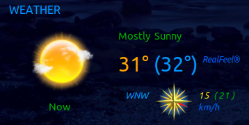

I have divided the Currently section into two parts.
Try:
${goto 45}${voffset -15}Currently:
${goto 45}${execpi 90 sed -n '1p' $HOME/Accuweather_RSS_conky_script/weather | awk '{$NF="";sub(/[ \t]+$/,"")}1' | awk '{$1=""; print $0}' | awk '{print substr($0,2)}' | cut -c1-30} ${execpi 90 sed -n '1p' $HOME/Accuweather_RSS_conky_script/weather | awk 'NF>1{print $NF}' | sed 's/C/°C/g'}
Just set ${voffset -15} because I'm using Forecast_Images_2016.
This will give you a ° sign in the current section.

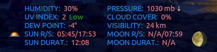

Moon inside Accuweather_conky_script
We already have a great Moongiant_conky_script made by @TBG.
I have managed (for now) to maintain it and even improve it.
The script now shows what the moon looks like in the sky in real time for your location.
In my accuweather conky I only use the 0.png image:
I tried to look for that image elsewhere because I don't need the rest of the data for my accuweather conky.
I created a new script that works great.
1) Inside Accuweather_conky_script create a  moon  folder
2) Open the moon folder and create a moon file (script):
## Important:
# Visit page: https://www.timeanddate.com/astronomy/france/paris and find your country and city.
# Just type in search field your City Name and click on PopUpMenu.
# Don't forget to replace the address with your own (instead of Paris, France)
# Your address format must be the same as below
    address="https://www.timeanddate.com/astronomy/france/paris"
    image_address=$(curl -H 'User-Agent: Mozilla/5.0 (X11; Linux x86_64; rv:80.0) Gecko/20100101 Firefox/80.0' "$address" | grep -o '[^ ]*src="/scripts/moon.php?i=[^ ]*' | awk -F'"' '{print $2}' | sed 's/amp;//g')
## Control
# echo $image_address
#### Moon Image
## Download
    curl -H 'User-Agent: Mozilla/5.0 (X11; Linux x86_64; rv:80.0) Gecko/20100101 Firefox/80.0' -o $HOME/Accuweather_conky_script/moon/moon.png "https://www.timeanddate.com$image_address"
## Yellow Moon
    convert $HOME/Accuweather_conky_script/moon/moon.png +level-colors ,#d4c240 $HOME/Accuweather_conky_script/moon/moon2.png
## Percent
     curl -H 'User-Agent: Mozilla/5.0 (X11; Linux x86_64; rv:80.0) Gecko/20100101 Firefox/80.0' "$address" | grep -o '[^ ]*<span id=cur-moon-percent>[^ ]*' | awk -F'>' '{print $2}' | sed 's/<\/span//' > $HOME/Accuweather_conky_script/moon/percent
3) At the beginning of the script you have instructions on how to change the address (replace Paris, France with your own)
4) Make the script executable.
Test the script (terminal):
$ bash $HOME/Accuweather_conky_script/moon/moon
Did you get this:
All that's left is to run the script in your accuweather conky and use the moon image:
${texeci 3600 bash $HOME/Accuweather_conky_script/moon/moon}

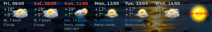

Gis Weather
I love it when there are no posts here for a long time.
That's how I know all of @TBG's scripts are working fine.
However, Gis Weather is still my favorite weather app and has been on my desktop for about 10 years.
https://github.com/RingOV/gis-weather
I added the GIS logo (bottom right) a long time ago for those who use the seven-day forecast:
https://forums.bunsenlabs.org/viewtopic … 63#p128763
I modified it a bit tonight and changed the position slightly.
New gis_logo.png:
Notes *
Download the logo and rename it to gis_logo.png.
Copy/paste the logo into the Gis Weather theme you are using.
That part now looks like this in the gis-weather.py  file:
                    # Marens Settings - Add Gis Weather Logo Bottom Right
                    self.draw_scaled_image(cr, x0+180, y0+128, self.find_icon('gis_logo'), 65, 65)
                    # End Marens Settings
