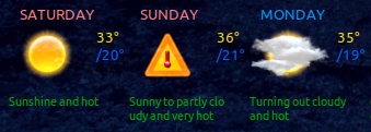

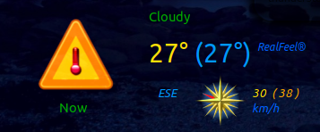

#4539 2024-06-26 14:26:52
Posts: 1,018
OK.
I played a little with Inkscape.
This is a simulation:
If you like them these are the new icons 30.png and 31.png:
Right click on the icon > Open Image in New Tab.
Slightly enlarged icons and better positioned content.
The size, of course, remained the same (250x150).
