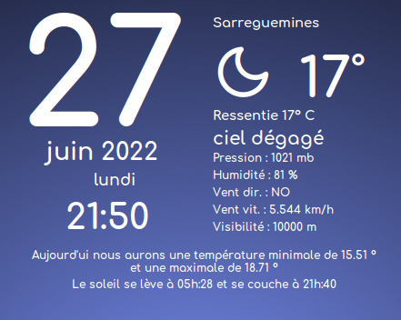

#4107 2022-06-27 16:54:00
Posts: 1,085
I made this conky with my old api key Openweathermap it work great .
I made a few scripts
anyone to change m/s in km/h
anyone to have the wind direction .
anyone to change   that 1656300526 in 24 hours for sunset & sunrise
it was a little difficult for my little head but it works.
I guess there is a simpler way.

#4110 2022-08-17 07:59:53
sad
Since two days the curr_cond is empty and not updated anymore.
Can you confirm this?
#4111 2022-08-18 07:11:51
Posts: 1,085
French version i have just sunset & sunrise  Anglish version work great.

#4116 2022-08-18 17:05:59
il.harun
Registered: 2020-06-04
Posts: 55
replace
#        sed '/current-weather-card card-module content-module non-ad/,/glacier-ad /!d' $HOME/Accuweather_conky_script/curr_cond_raw > $HOME/Accuweather_conky_script/curr_cond_temp
        sed '/current-weather-card/,/glacier-ad /!d' $HOME/Accuweather_conky_script/curr_cond_raw > $HOME/Accuweather_conky_script/curr_cond_temp

#4117 2022-08-18 18:07:53
Sorry, @il.harun, apart from the fact that you just don't write that in code tags, you now also leave out the line number.
The
# sed '/sunrise-sunset card-module content-module/,/temp-history content-module/!d' $HOME/Accuweather_conky_script/curr_cond_raw > $HOME/Accuweather_conky_script/curr_cond_temp1
does not exist here and has been removed here before
https://forums.bunsenlabs.org/viewtopic … 25#p122925
Let's see how long. wink
Thanks!

The script has been on Google Drive since August 17
#4119 2022-08-18 19:22:43
Posts: 234
Thank you Sir, that solved it.
All good now; hopefully will last for a loooong time...

il.harun wrote:
replace
Tanks work great english & french.
